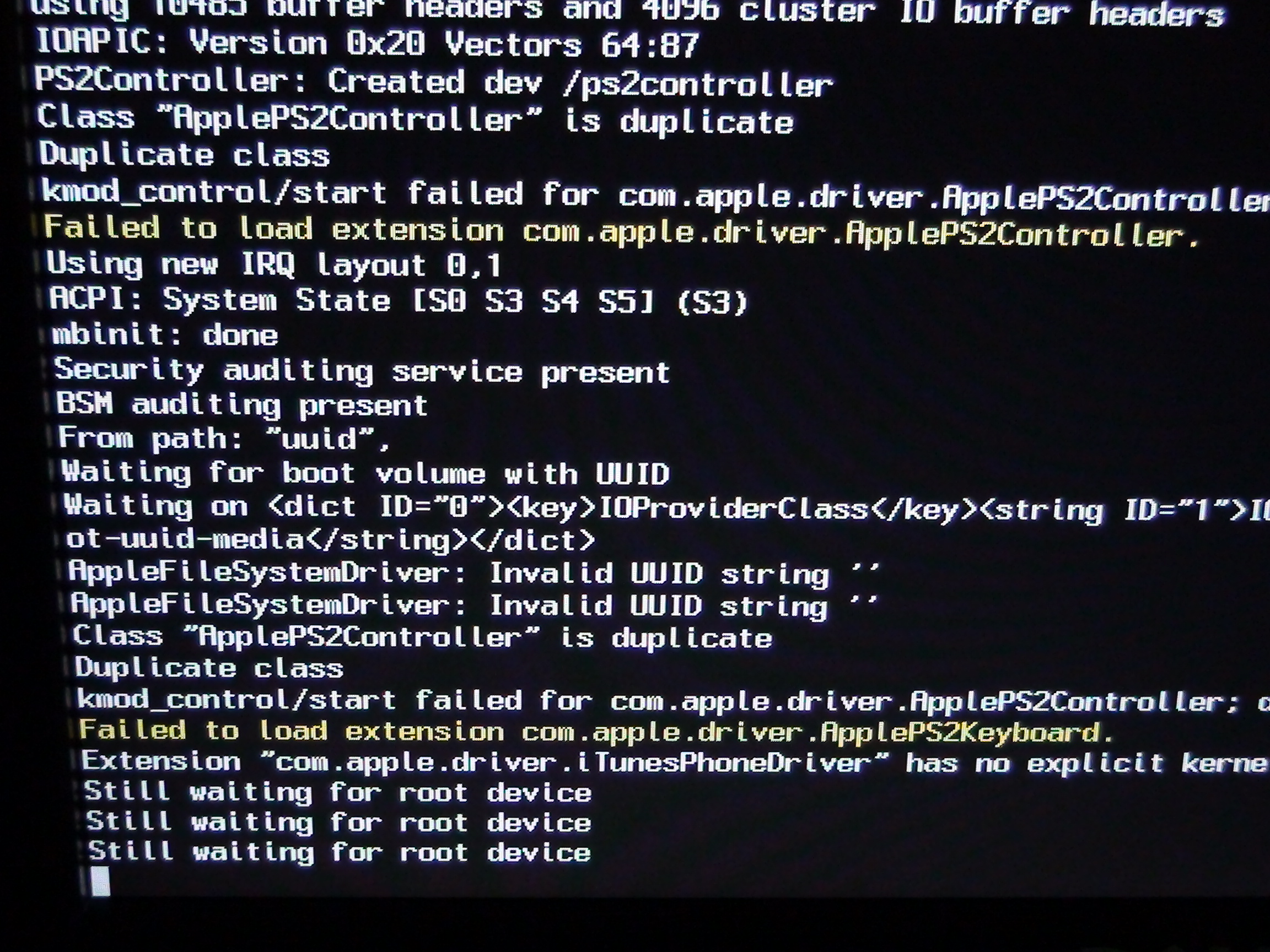

joshh20 Posted July 2, 2010 Share Posted July 2, 2010 I have read a few other posts, but could not find anything that was the same as my problem, sorry if someone has already had the exact same problem as me. I have SSE3, and I know my hardware is compatible because I got it to work once, but now I can't figure it out. I have tried almost every different driver configuration in the iATKOS disk, and I simply can not get it to run. I should also note that I have an IDE hard drive installed. I have a picture of the screen and my system info, and I will try to show as much information here as I can, thanks in advance. Hackintosh_Info.txt Link to comment https://www.insanelymac.com/forum/topic/223645-problems-with-iatkos-drivers-please-help/ Share on other sites More sharing options...
MaLd0n Posted July 2, 2010 Share Posted July 2, 2010 You'll see "Still waiting for root device" when OS X can't talk to your drive controller, either because you haven't installed the right driver for it, because your PATA drives are jumpered/cabled wrong, your drives are attached to an unsupported controller (then you're out of luck), or SATA is not set to AHCI mode in the BIOS. Most modern motherboards have a secondary SATA controller from JMicron, Silicon Image or Marvell. The SATA ports of the secondary controller are normally colored differently (white or orange) than those of the primary controller (usually red). Check your motherboard manual to see which ports belong to which controller. There are drivers for OS X for the most common secondary controllers, but the main controller (Intel ICHx or Nvidia nForce) is usually the more compatible since Apple use Intel ICHx and nForce as well. If you have problems with drives not being recognized, either plug them into a port on the main drive controller, or find and install drivers for the "off-chipset" drive controller. For PATA (IDE) drives, try a different jumper setting and/or cable position, and make sure you're using 80 conductor cables. If you have two IDE ports, put each device at the end of it's own cable and jumper it as master device. There's very limited support for PATA drives in OS X (IIRC no modern Macs have PATA devices?) so you'll probably need a community provided driver to get your PATA drives running. Again Intel and Nvidia are the easiest to get working. The Chameleon bootloader official download includes some injector or "legacy" kexts for many common PATA and SATA controllers. If your board has a Marvell 6xxx controller, you need AppleVIAATA or SuperVIAATA.kext. There are also nForceATA and ATIATA kexts out there. Older Intel boards with ICH5 might need a patched AppleIntelPIIATA.kext. Intel ICHx or nForce SATA controllers in AHCI mode (set in the BIOS) are the most compatible and easiest to get working. gringo vermelho Link to comment https://www.insanelymac.com/forum/topic/223645-problems-with-iatkos-drivers-please-help/#findComment-1503449 Share on other sites More sharing options...
joshh20 Posted July 3, 2010 Author Share Posted July 3, 2010 Does iATKOS v7 support the IDE drivers? and which driver would that be? -Josh Link to comment https://www.insanelymac.com/forum/topic/223645-problems-with-iatkos-drivers-please-help/#findComment-1503505 Share on other sites More sharing options...
arifpaan Posted July 3, 2010 Share Posted July 3, 2010 try booting with busratio=20. sometimes it fix that error. Link to comment https://www.insanelymac.com/forum/topic/223645-problems-with-iatkos-drivers-please-help/#findComment-1503571 Share on other sites More sharing options...
