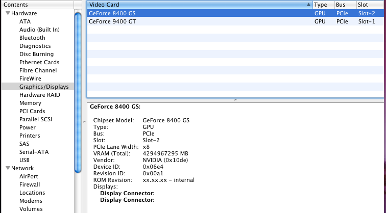

Hi I am trying to get dual video cards working with Snow Leopard 10.6.4. Here is my setup
  • Gigabyte GA-EP45T0USB3P
  • Core2Duo E6500 (OC to 3.85 Ghz)
  • Geforce 9400 GT
  • Geforce 8400 GS
I've used Kakewalk 2.2 installer for GA-EP45-UD3R (closest to my board) which installs the Chameleon 2.0 RC4.
These are extra KEXTs that I am running
fakesmc.kext
JMicronATA.kext
VoodooHDA.kext (and removed AppleHDA.kext. Otherwise kernel panic at boot)
OK, so here is where I am now. Fresh 10.6.0 will not even boot with the second video cards in the PEG2 position. However, once I've updated to 10.6.3 (and .4 later) it will boot with the card in place, and it somewhat shows the info under the "More Info" (see the attached image). It lists both cards, but the VRAM info on the second card (8400 GS) is wrong.

After multiple tries I am still getting kernel panic during the boot with the new DSDT.aml file. Any suggestions?
https://www.insanelymac.com/forum/topic/222752-help-with-dual-video-cards/
OK, I got it to not kernel panic with the below code. However, the triple monitors via dual video cards is still not working. Can someone take a look at the code below and provide feedback?
