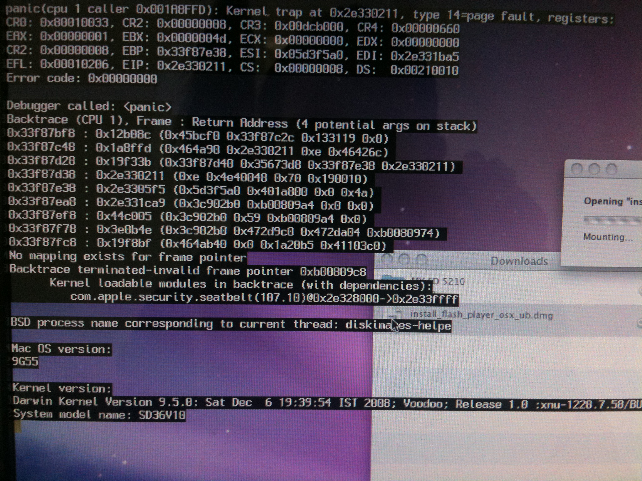

spidy01 Posted June 17, 2010 Share Posted June 17, 2010 Hi all Im new to OSX I have successfully installed the ipc 10.5 and all is good, but every time I try to download and install it crashes with this message. I use a: Shuttle xpc FD36V10 Intel Pentium D945 3.40 Nvidia GeForce 7600 GS -512 MB Thank you Link to comment Share on other sites More sharing options...
MaLd0n Posted June 17, 2010 Share Posted June 17, 2010 The best is you use a kernel version of the same system, for example for the system 10.5.7, kernel 9.7.0. Besides the seatbelt.kext and System.kext must match the kernel version. Link to comment Share on other sites More sharing options...
satch_yt Posted June 20, 2010 Share Posted June 20, 2010 it's probably trying to mount the dmg you downloaded, it's the "DMG mount issue" which is very popular, do a lil search about it and you'll find the right seatbelt.kext for your system. to make sure, try to mount a dmg, if it crashes, it's your seatbelt.kext. Link to comment Share on other sites More sharing options...
