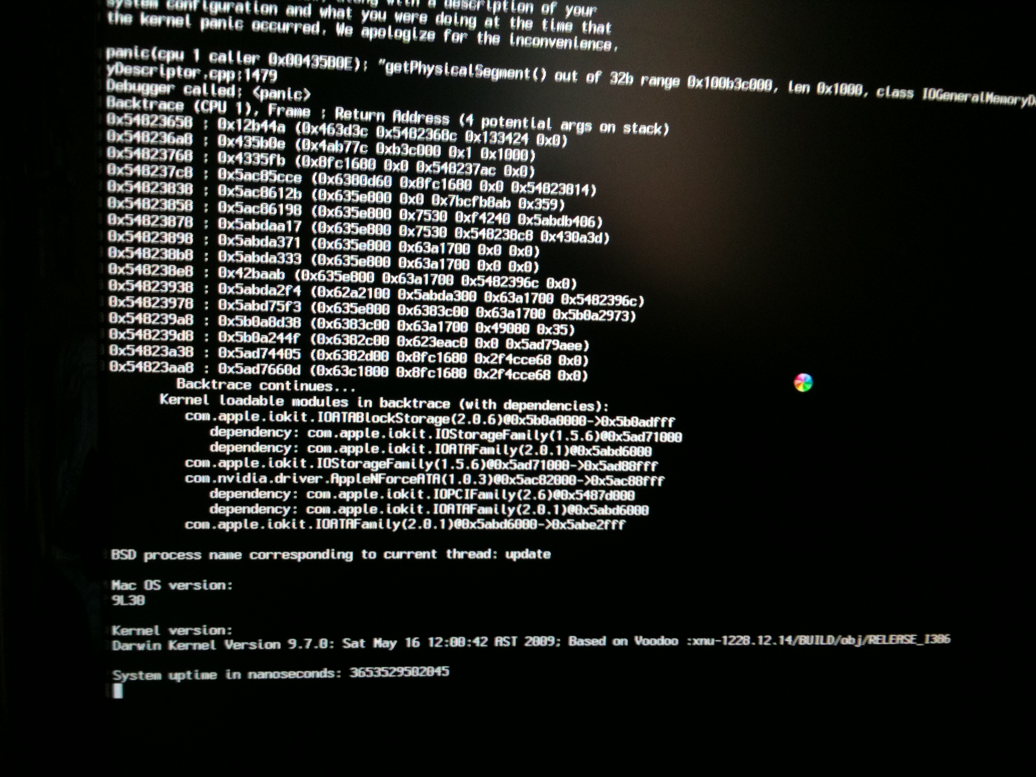

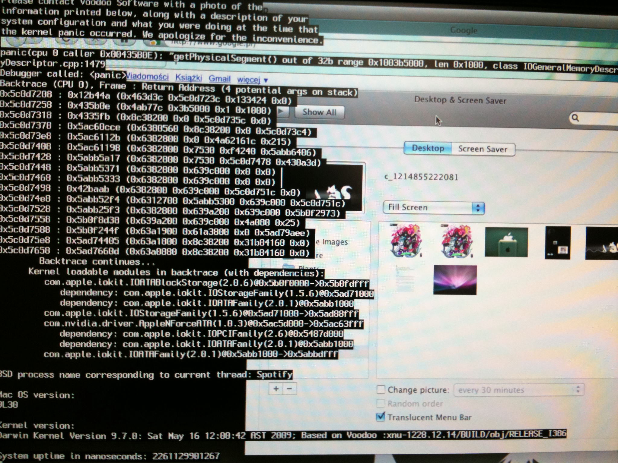

Ren. Posted June 16, 2010 Share Posted June 16, 2010 Hi there! Recently I've got a problem with my Hackintosh - I am getting Kernel Panics everytime I download about 500MB of data, (XCode for example). I am including full details of my system from the System Profiler and photos of the KP. (The KP also occurs when loading Team Fortress 2) Mini specs: iATKOS v7 updated to 10.5.8 with iDeneb Delta Update Kit Mac OS X Leopard 10.5.8 Gigabyte GA-M52L-S3 with an NForce Chipset (I guess it's 520L) AMD Athlon 64 x2 5200+ @ 2.7GHz 4GB of ram DDR2 ATi Radeon HD4850 (only one display working sadly...) Sound Blaster Live! 24-Bit (SB0040) Realtek RTL8319 (ethernet) Please, help me! Ren. UPDATE: It seems I have fixed the KP issue. All I have done is: 1. Remove the AppleNForceATA.kext from /System/Library/Extensions/ IF IT EXISTS 2. Download this file: http://darwin-ata.googlecode.com/files/App...rceATA.kext.zip 3. Unzip the file and copy the KEXT to /System/Library/Extensions/ 4. Fire up Terminal and type in it: sudo chown -R root:wheel /System/Library/Extensions/AppleNForceATA.kext sudo rm -R /System/Library/Extensions.mkext 5. Make sure you don't have any CD inside your drive and reboot. 6. When booting give the bootloader flags: -v -f That will do it. 7. If you will freeze at this point, don't worry, reset your Hackintosh and redo this again. 8. ... 9. Profit! I hope I've helped renyneys_mac_pro.zip AppleNForceATA.kext.zip Link to comment https://www.insanelymac.com/forum/topic/221364-solved-nforce-driver-kernel-panic/ Share on other sites More sharing options...
