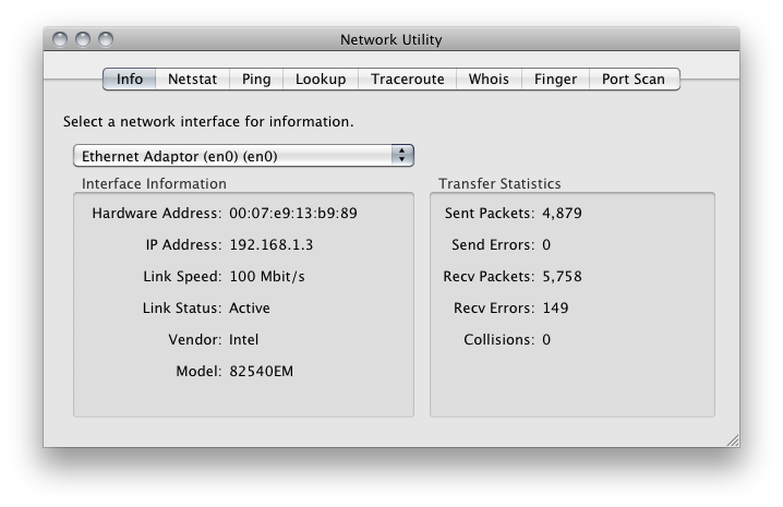

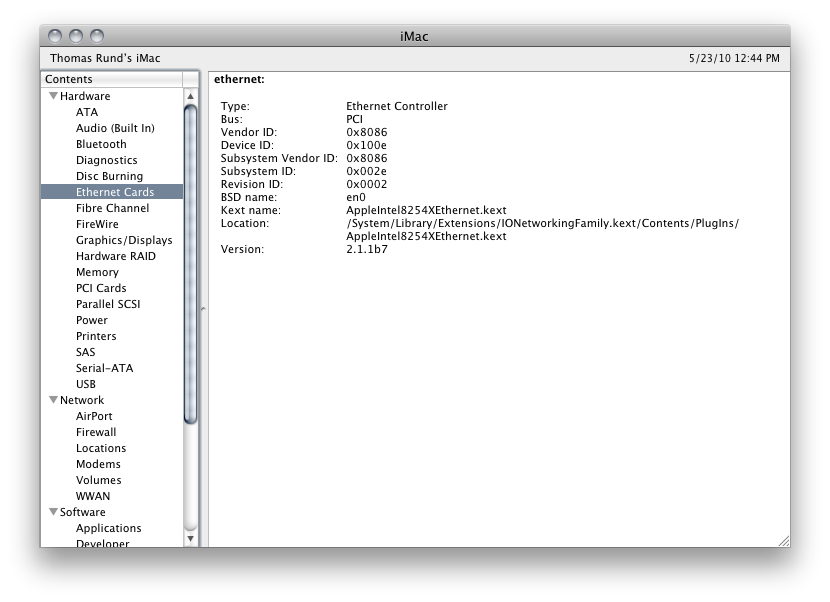

tom btc Posted May 26, 2010 Share Posted May 26, 2010 I had an old power mac G4 450MHz which I had many years ago added an intel gigabit lan card into, the card worked flawlessly on 10.4.X for years with heavy use. It also seemed to work fine with 10.5 but I can't say for sure cause I didn't run the OS for long. Well anyway, I took the card out of the Power Mac and put it into my Hackintosh build which I had everything else working on before I put in the NIC. Gigabyte G31M-E2SL 2.8 C2D 2GB RAM PNY Nvidia 210 DVI/HDMI/VGA I figured since the card was working fine already in a mac it would drop right in. Well it was recognized right off the bat and appeared to aquire a good IP address, so I opened up software update to get all my updates. It started off working well for about 2 minutes, then the download stopped and the Hackintosh lost it's IP address and nothing I did would get it back short of a reboot. I did this many times, every time either the card lost the IP after about a minute or it would download fine for about 5 minutes and it would then KP. Any ideas/suggestions? Screenshots attached. Link to comment https://www.insanelymac.com/forum/topic/219439-intel-82540em-intel-pro-1000-and-1063/ Share on other sites More sharing options...
lordstorm Posted May 26, 2010 Share Posted May 26, 2010 Same exact card and problem. tried the smalltree driver, but that no longer works with stock intel cards... Link to comment https://www.insanelymac.com/forum/topic/219439-intel-82540em-intel-pro-1000-and-1063/#findComment-1475891 Share on other sites More sharing options...
tom btc Posted May 26, 2010 Author Share Posted May 26, 2010 So there is no solution and I need to buy another card then? Link to comment https://www.insanelymac.com/forum/topic/219439-intel-82540em-intel-pro-1000-and-1063/#findComment-1476270 Share on other sites More sharing options...
