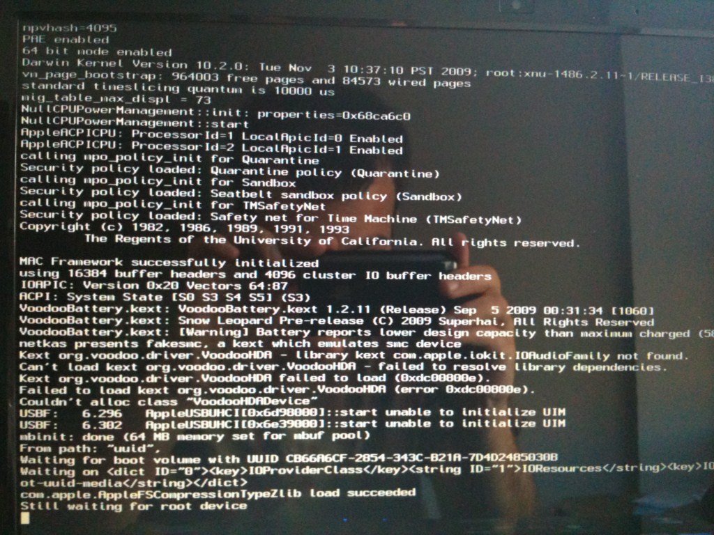

ogr Posted May 17, 2010 Share Posted May 17, 2010 Waiting for root device has something to do with ACHI mode,thats something like IDE but better.I think you have in IDE Mode so try to switch in your Bios to AHCI under your SATA drives Link to comment https://www.insanelymac.com/forum/topic/214603-any-idea-with-geforce-g210m/#findComment-1470235 Share on other sites More sharing options...

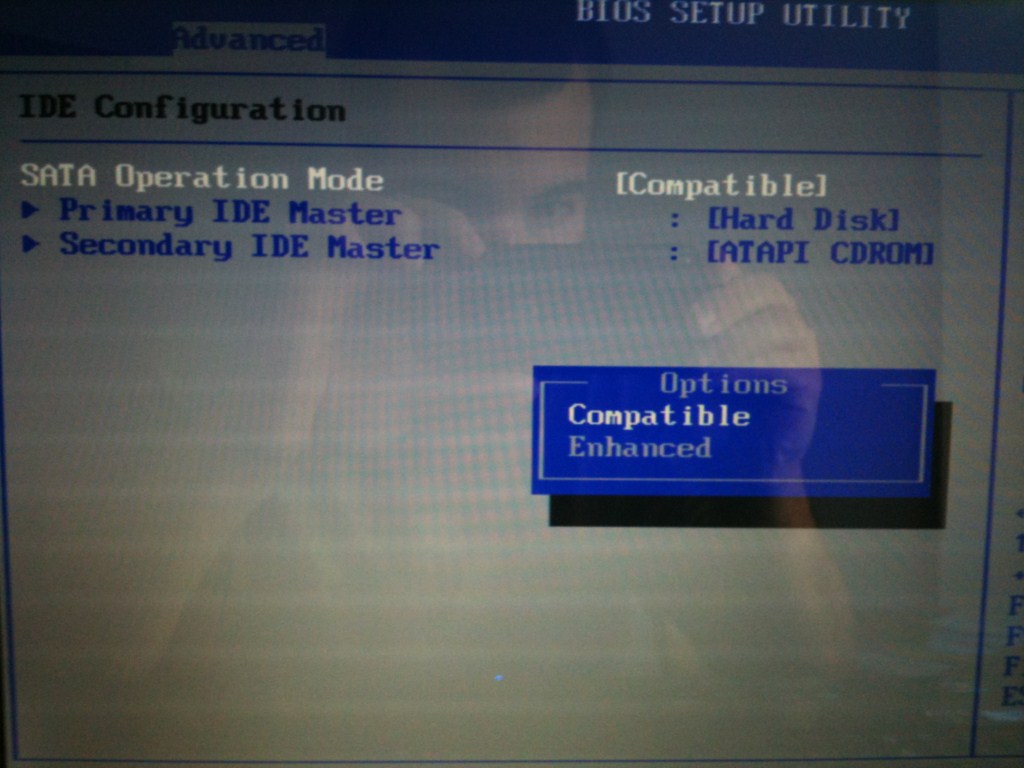

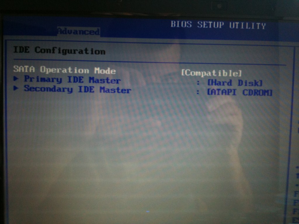

seahawkwest Posted May 18, 2010 Author Share Posted May 18, 2010 Waiting for root device has something to do with ACHI mode,thats something like IDE but better.I think you have in IDE Mode so try to switch in your Bios to AHCI under your SATA drives Ok, thanks again but, on IDE configuration i have: - SATA Operation Mode: (option selected enhanced). i can select enhanced or compatible. - AHCI Port 0 Hard Disk: when i selected displays SATA Port0: (option selected auto). i can select auto or not installed. Device: Hard Disk Vendor: ST950032 ... Size: 500.1 GB LBA Mode: Supported S.M.A.R.T. : Supported - AHCI Port 1 Atapi CDROM: when i selected displays SATA Port1: (option selected auto). i can select auto or not installed. AHCI Port1 Device: ATAPI CDROM Vendor: HL-DT-ST DVDRAM GU10N LBA Mode: Supported I will prove today all the options to see if i have something of luck to change and post it here. regards Link to comment https://www.insanelymac.com/forum/topic/214603-any-idea-with-geforce-g210m/#findComment-1470634 Share on other sites More sharing options...
seahawkwest Posted May 18, 2010 Author Share Posted May 18, 2010 it's imposible. Always the same error. Im using empire efi 1.08 Snow Leopard Retail My laptop is already on AHCI mode by default. if i change the option enhanced (selected by default), for compatible, my laptop is on ide mode. With this option always appears still waiting for root device. On AHCI mode appears too. I don't understand where is the problem. I think the only possibility is using iatkos s for me. regards. Link to comment https://www.insanelymac.com/forum/topic/214603-any-idea-with-geforce-g210m/#findComment-1470821 Share on other sites More sharing options...

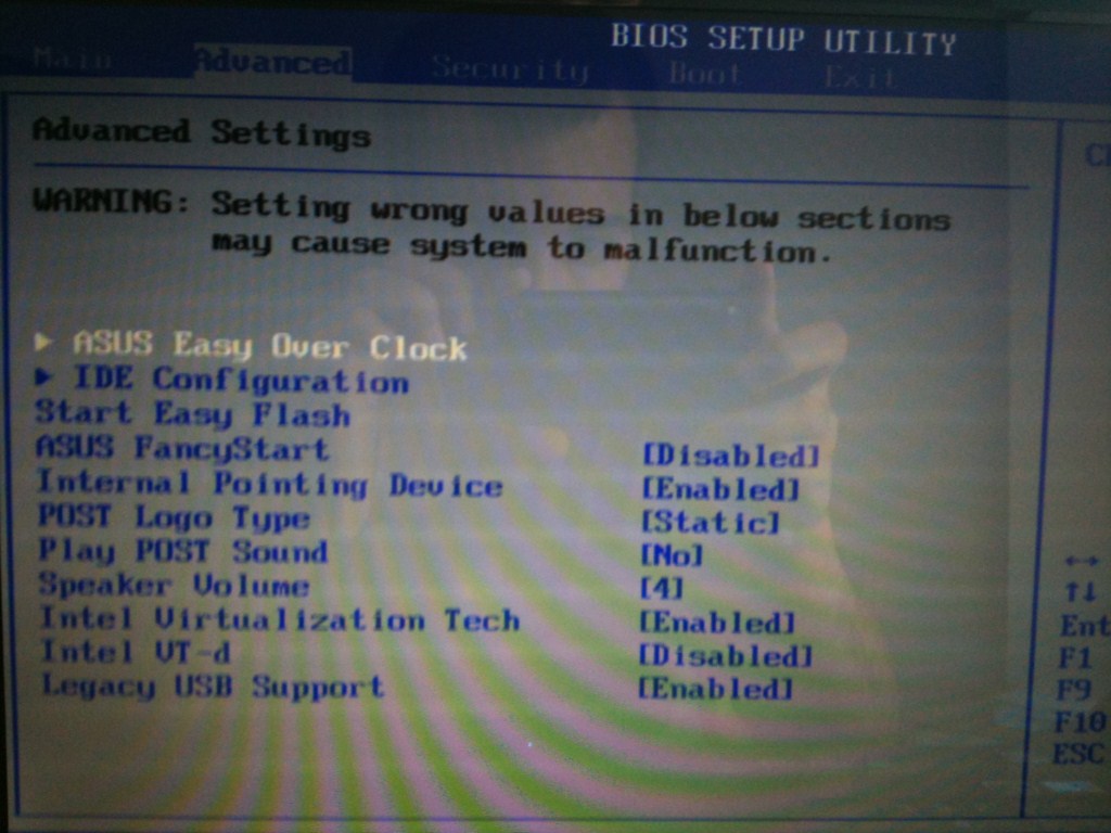

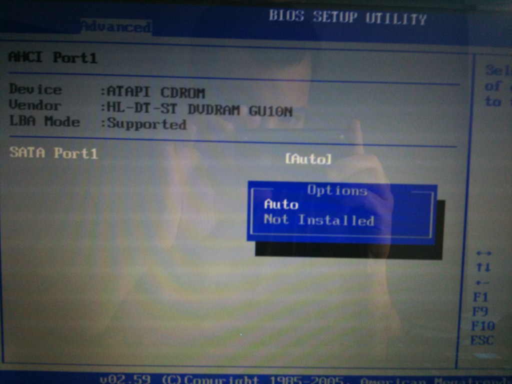

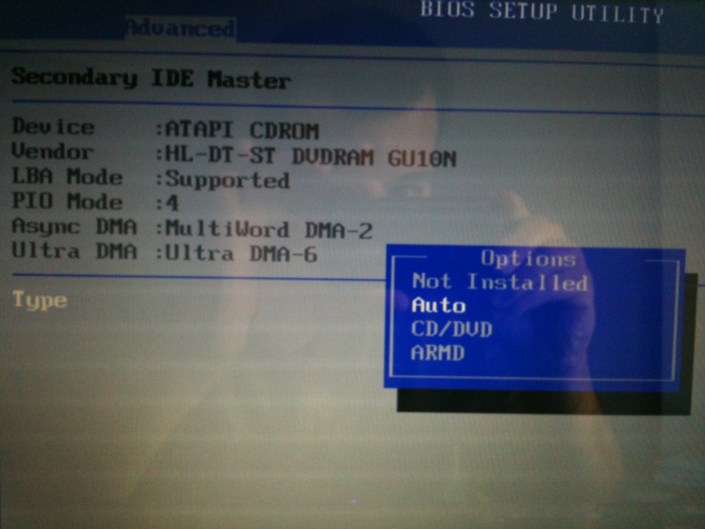

ogr Posted May 19, 2010 Share Posted May 19, 2010 OK,so the Problem is clear on your provided photos.Your Board does not have Ahci mode for you SATA drives only for the Optical one (CD/DVD) but not Hard Drives.Please provide more Data about your motherboard. You know i was forced to flash my bios from another modell becouse of AHCI mode.It aint gonna work without AHCI . Regards Oliver Link to comment https://www.insanelymac.com/forum/topic/214603-any-idea-with-geforce-g210m/#findComment-1471723 Share on other sites More sharing options...
seahawkwest Posted May 20, 2010 Author Share Posted May 20, 2010 OK,so the Problem is clear on your provided photos.Your Board does not have Ahci mode for you SATA drives only for the Optical one (CD/DVD) but not Hard Drives.Please provide more Data about your motherboard. You know i was forced to flash my bios from another modell becouse of AHCI mode.It aint gonna work without AHCI . Regards Oliver OK thanks When i had installed everest program he said to me that i have intel cantiga gs45 but ¿ unknown motherboard ? . But it made a technical report of the laptop on html. I uploaded here. Thanks so much for help me Regards Motherboard: Tipo de CPU Mobile DualCore Intel Core 2 Duo, 1333 MHz (6.5 x 205) Nombre del motherboard Desconocido Chipset del motherboard Intel Cantiga GS45 Memoria del sistema 4064 MB (DDR2-800 DDR2 SDRAM) DIMM1: Nanya NT2GT64U8HD0BN-AD 2 GB DDR2-800 DDR2 SDRAM (6-6-6-18 @ 400 MHz) (5-5-5-15 @ 333 MHz) (4-4-4-12 @ 266 MHz) DIMM3: Nanya NT2GT64U8HD0BN-AD 2 GB DDR2-800 DDR2 SDRAM (6-6-6-18 @ 400 MHz) (5-5-5-15 @ 333 MHz) (4-4-4-12 @ 266 MHz) Tipo de BIOS AMI (09/21/09) Propiedades del BIOS: Fabricante American Megatrends Inc. Versión 213 Fecha de salida 09/21/2009 Tamaño 1024 KB Propiedades del motherboard: Identificación del motherboard 64-0100-000001-00101111-092109-Cantiga$UL50V201_BIOS DATE: 09/21/09 VER: 213 Nombre del motherboard Desconocido Report.htm Link to comment https://www.insanelymac.com/forum/topic/214603-any-idea-with-geforce-g210m/#findComment-1472128 Share on other sites More sharing options...
Amazing Lemur Posted May 24, 2010 Share Posted May 24, 2010 Seahawkwest, You can make the G210M the default by going to the "Advanced" tab in the BIOS then selecting "IDE Configuration" and then changing SATA Operation Mode to the opposite of what it is now. (I think Enhanced is nVidia G210M and Compatible is Intel x4500MHD, but I don't remember so try both). I am also trying to install Snow Leopard and have fully functioning graphics, so I will let you know how it goes. Link to comment https://www.insanelymac.com/forum/topic/214603-any-idea-with-geforce-g210m/#findComment-1474913 Share on other sites More sharing options...
seahawkwest Posted May 25, 2010 Author Share Posted May 25, 2010 Seahawkwest, You can make the G210M the default by going to the "Advanced" tab in the BIOS then selecting "IDE Configuration" and then changing SATA Operation Mode to the opposite of what it is now. (I think Enhanced is nVidia G210M and Compatible is Intel x4500MHD, but I don't remember so try both). I am also trying to install Snow Leopard and have fully functioning graphics, so I will let you know how it goes. Thanks so much, but always I had enhanced mode, no compatible mode. With Iatkos v7 i no have qe/ci On the description of the bios says: "Select compatible to set serial ATA Channel at IDE Mode for OS not supporting Native Sata controller like Windows XP and 2000 or it will run into BSOD when installing windows" On the previous post, Oliver said to me that the problem is my Board does not have Ahci mode for my SATA drives only for the Optical one (CD/DVD) but not Hard Drives. My Hard disk have two options auto or not installed. The unique solution is install iatkos s and then try switching video card. With empire efi install snow leopard is not posible on my laptop. Thanks again. Link to comment https://www.insanelymac.com/forum/topic/214603-any-idea-with-geforce-g210m/#findComment-1475072 Share on other sites More sharing options...
