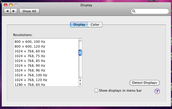

I'm having some trouble with my GMA950 (Vendor: Intel 0x8086 Device ID: 0x27ae Revision ID: 0x0003) on 10.6.2 (With all the latest updates from Software Update) I can't get it into 1024x600 mode.
I'm using the driver pack found here prasys.co.cc
My com.apple.Boot.plist in /Extra has
Graphics Mode 1024x600x32
device-properties 6d0000000100000001000000610000000200000002010c00d041030a000000000101060000027fff
0400100000006d006f00640065006c0000000b000000474d4120393530200000004100410050004c
0
02c00480061007300500061006e0065006c0000000800000001000000
in it. I'm also fairly positive Quartz Extreme is running, as I get the ripple effect and have a transparent menubar. But no matter what I do (Short of using SwitchResX, which I'd like to avoid if at all possible) I can't get it to show 1024x640.
Here's my kextstat as well.

Does anyone know how I can get this working? Thanks.

I'm in the same problem on my Advent 4213 with Mac OS X 10.6.7
All works, but still in 800x600 or 1024x768
I have 3D and transparent bar (screensave works, grapher 3D works fine)

The strange, is before my disk crash, I have 1024x600 ... I don't remember how I do this before ...
Need help please !

Hi
Read the below, it may help you. Use DSDT to get it up & updates should not break it also.
With the DSDT patch you must use original (vanila/stock) kexts.
I got my desktop fixed with this & with this forum help.
DSDT editor - http://www.insanelymac.com/forum/index.php?showtopic=223205
File>extract DSDT
Patch> Open> DTGP.txt
IASL>Compile>Fix Errors
IASL> Save AML As> Desktop
Patch>Open> GMA950 laptop.txt
IASL>Save AML AS>Desktop>Overwrite
Exited DSDT Editor
Go>Go To Folder> /Extra
Moved dsdt.aml from desktop to /Extra
Reboot
