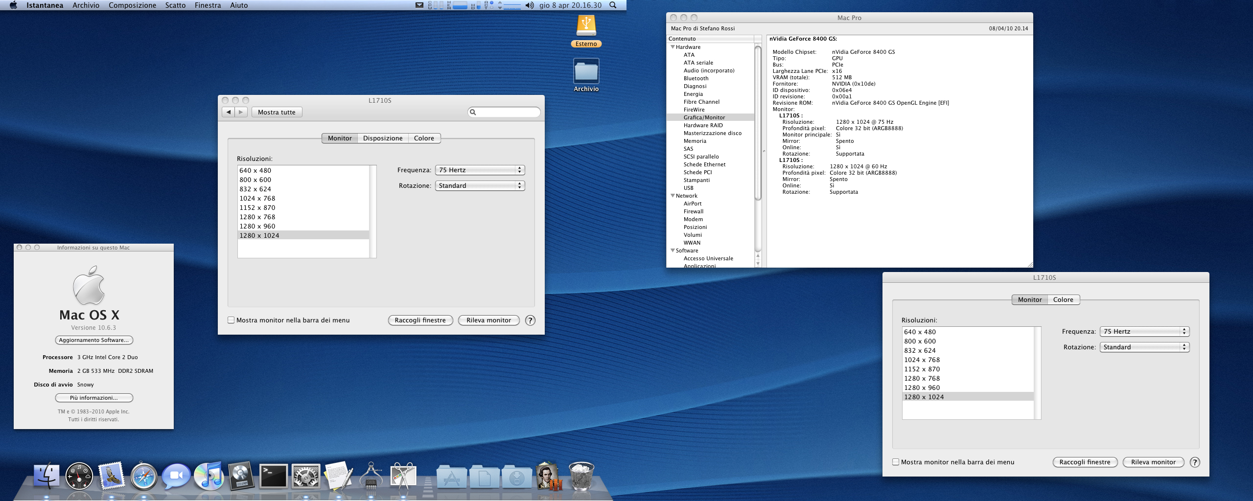

stefa.rossi Posted April 8, 2010 Author Share Posted April 8, 2010 Ciao a tutti, ieri sono andato in un negozio nel quale avrei dovuto comprare la Point of View, ma avevano finito le scorte. Allora, sotto promessa da parte del venditore di poter di poter cambiare la scheda in caso di incompatibilità, ho acquistato l'8400GS ASUS. La scheda, con la seguente EFI string, funziona perfettamente: 6c0200000100000001000000600200000d00000002010c00d041030a010000000101060 000010101060000007fff04001e00000072006f006d002d007200650076006900730069006f006e00 00002e0000006e5669646961204765466f7263652038343030204753204f70656e474c20456e67696 e65205b4546495d22000000400030002c006400650076006900630065005f00740079007000650000 000b000000646973706c6179100000004e00560043004100500000001800000004000000000003000 400000000000007000000000e0000006e0061006d00650000000b000000646973706c617914000000 400030002c006e0061006d0065000000120000004e5644412c446973706c61792d41100000006d006 f00640065006c0000001a0000006e5669646961204765466f72636520383430302047530e0000004e 00560050004d000000200000000100000000000000000000000000000000000000000000000000000 014000000400031002c006e0061006d0065000000120000004e5644412c446973706c61792d422000 0000400031002c0063006f006d00700061007400690062006c00650000000e0000004e5644412c4e5 64d6163220000005600520041004d002c0074006f00740061006c00730069007a0065000000080000 000000002020000000400030002c0063006f006d00700061007400690062006c00650000000e00000 04e5644412c4e564d616322000000400031002c006400650076006900630065005f00740079007000 650000000b000000646973706c61791c0000006400650076006900630065005f00740079007000650 000000f0000004e5644412c506172656e74 In allegato uno screenshot con la 8400 collegata a 2 schermi (1280x1024). In ogni caso, grazie per i vostri suggerimenti ! Link to comment https://www.insanelymac.com/forum/topic/213841-risolto-nvidia-8400gs-msi-o-point-of-view/#findComment-1444643 Share on other sites More sharing options...
