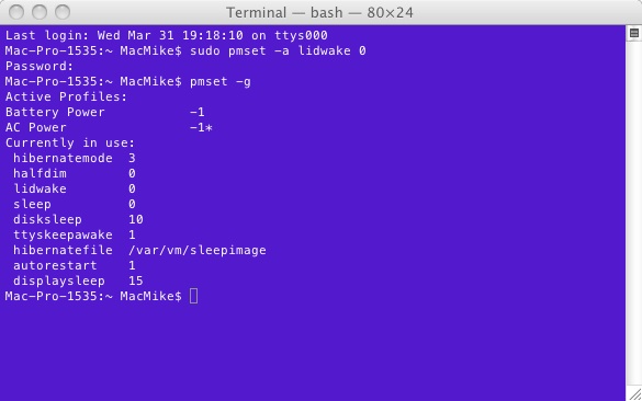

bluedogmike Posted March 28, 2010 Share Posted March 28, 2010 I was able to enable sleep by tweaking my dsdt.aml file. It has a powerbutton fix and speedstepping (p-states) . Sleep is working well and wakes via powerbutton. Sleep on lid close is working. But I feel this is the key to getting all other sleep issues corrected. *Sleep only works while plugged in to ac, trying to figure out what the problem is........ Find attached the dsdt.aml file. Working on 10.5.8, also works with Snow Leo 10.6.1 You MUST set your lidwake to 0 for this fix to work at all. Attached is a shot of the terminal with the proper commands dsdt.aml.zip Link to comment https://www.insanelymac.com/forum/topic/213080-dell-studio-15-i-need-a-few-fixes/#findComment-1436114 Share on other sites More sharing options...
