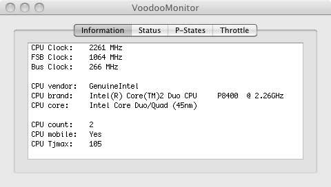

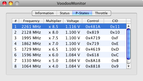

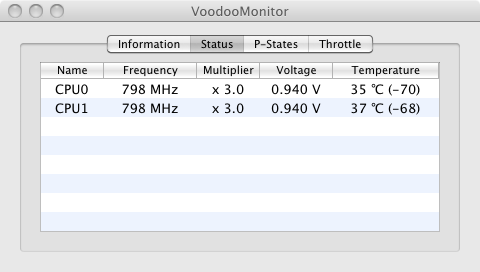

TheOriginalPol Posted February 22, 2010 Author Share Posted February 22, 2010 Hey Napalm, AppleIntelCPUPowerManagement.kext has always seemed to be running fine in system profiler (I deleted the disabler kexts immediately after I knew they wouldn't fix my problem). Of course I don't know how much that actually means, haha. Anyways I've always figured PM was working on my install, though I've never actually known a surefire way to tell (other than how quickly my battery dies) so thanks a lot for that tip. It looks to me like PM is working correctly according to VoodooMonitor, but I don't know -- you tell me: Link to comment https://www.insanelymac.com/forum/topic/211265-sleep-pm45ich9/#findComment-1415115 Share on other sites More sharing options...
