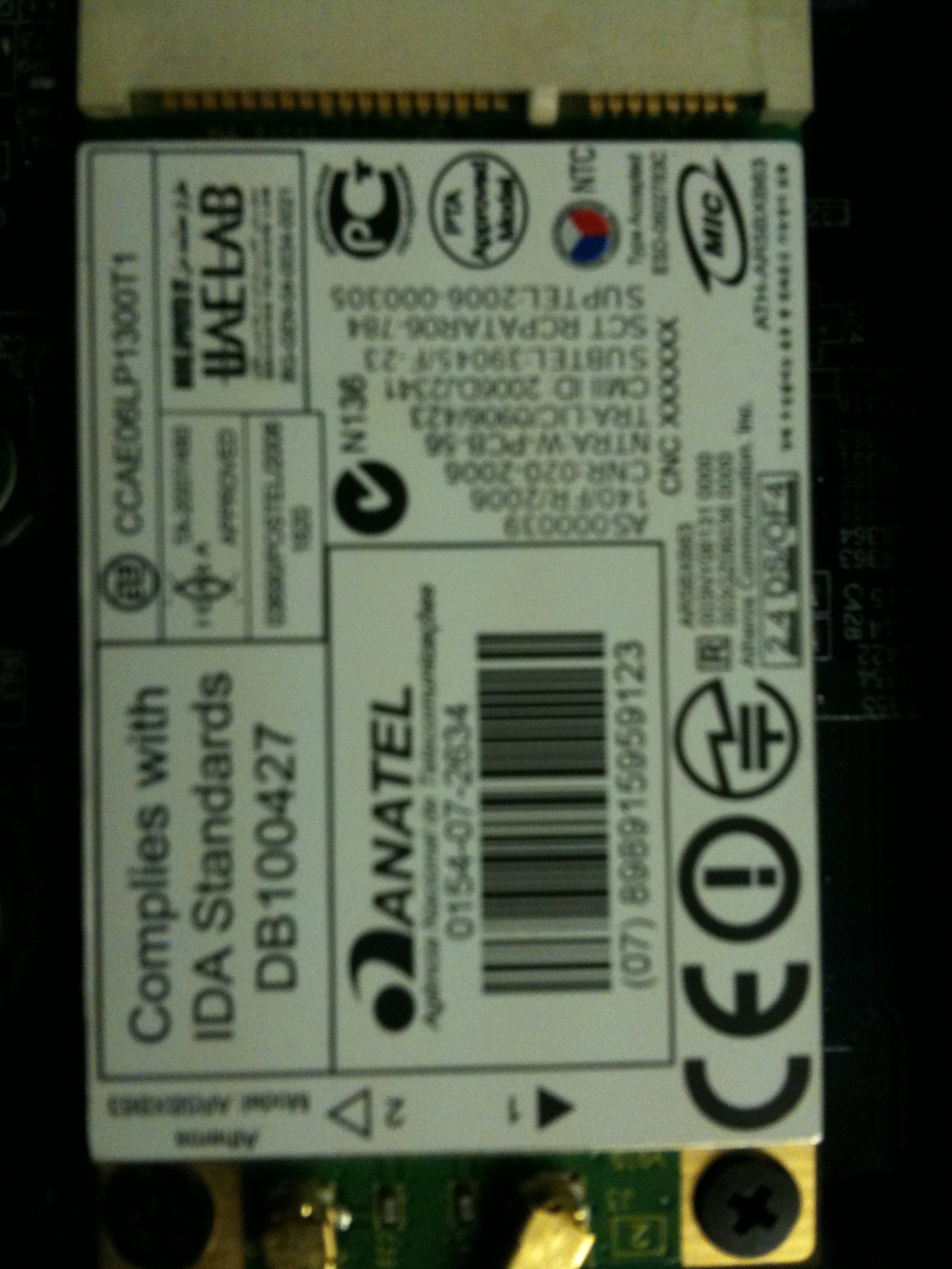

jellymonster Posted February 19, 2010 Author Share Posted February 19, 2010 I had a problem with keys 'stuck' on resume from sleep, solved using the version in this posthttp://www.insanelymac.com/forum/index.php...t&p=1314293 (it's for Snow Leopard, don't know if it will work on Leopard) Which version are you using? I'm using 10.5.8, but it seems to have fixed itself =) I can't seem to find what wireless card I have, but I got a picture if it helps. Edit: Bit of google searching later, I think it comes under Atheros AR5006 Link to comment https://www.insanelymac.com/forum/topic/211113-1058-on-c700-no-wireless-or-keyboardtracker-pad/#findComment-1413243 Share on other sites More sharing options...
oldnapalm Posted February 19, 2010 Share Posted February 19, 2010 Hey man, how do you have an wifi card approved by ANATEL? I never used one of those, but some people reported to get it working http://www.insanelymac.com/forum/index.php?showtopic=61260 Link to comment https://www.insanelymac.com/forum/topic/211113-1058-on-c700-no-wireless-or-keyboardtracker-pad/#findComment-1413391 Share on other sites More sharing options...
