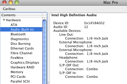

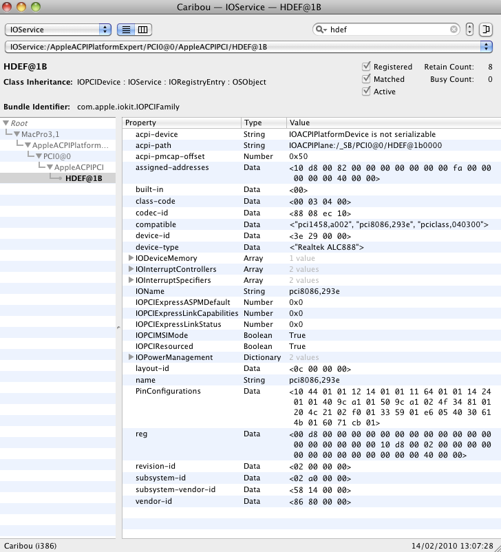

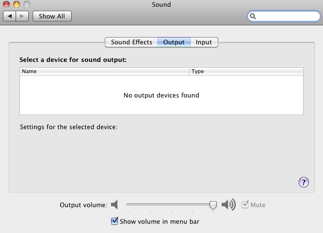

IORegistry Explorer Screen Shot Of HDEF:
System Preferences Screen Shot:
System Profiler Screen Shot:

I hadn't, thanks for the suggestion, unfortunately still no audio. :wacko: Titain made a similar suggestion here http://www.insanelymac.com/forum/index.php...t&p=1410292 but his kext didn't work either :(
