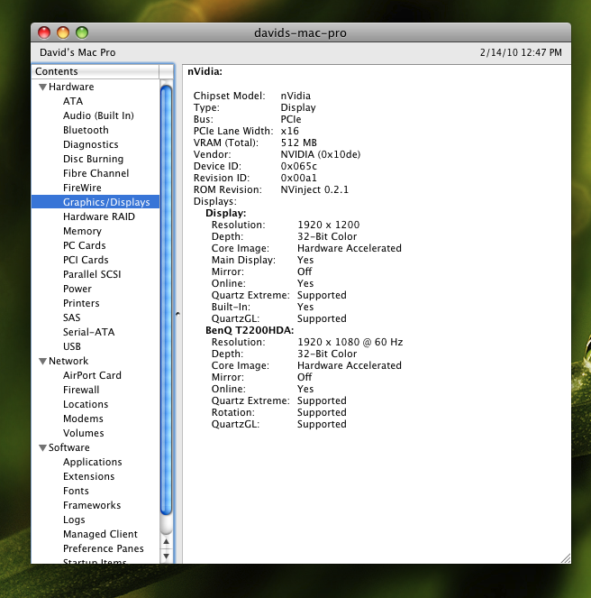

breakoff Posted February 14, 2010 Share Posted February 14, 2010 8530W for FX770m display "04000000 00000d00 40000000 00000007 00000000" modify NVject.kext NVCAP value by the new value, you can get 2 or 3 displays in your osx. Enjoy. Link to comment https://www.insanelymac.com/forum/topic/210759-workable-8530w-fx770m-nvcap-value/ Share on other sites More sharing options...

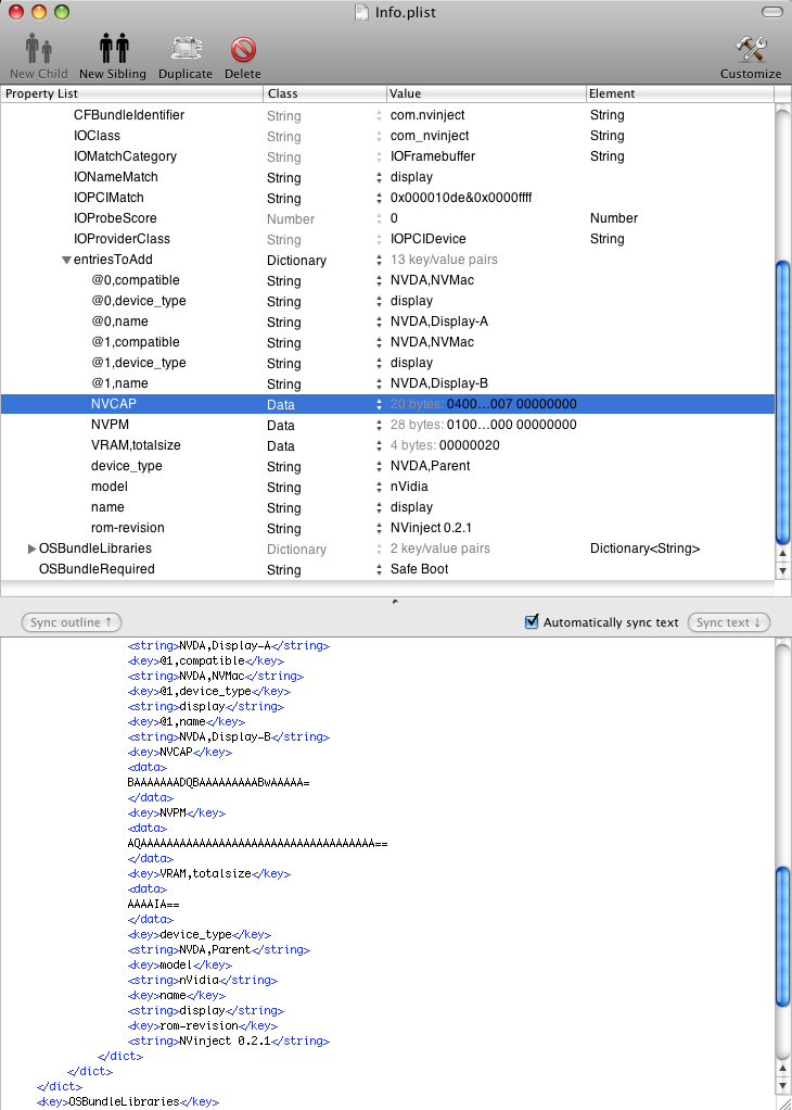

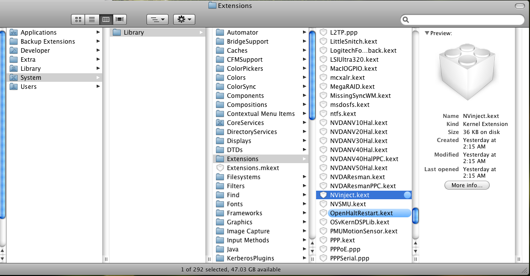

breakoff Posted February 15, 2010 Author Share Posted February 15, 2010 1. Find NVject.kext file at \System\Library\Extensions 2. Open the Content and edit the info.plist with PlistEdit app. 3. Find the NVCAP value and change the value to "04000000 00000d00 40000000 00000007 00000000" this one. 4. Save it and Repair Disk Permission then restart. 5. Go to your "System Preferences" use the "Displays" and just press the "Detect Displays", Remember attach your D-Sub or HDMI cable first. The picture for PlistEdit Pro edit the NVject. Change the NVCAP value at the uppper setting not in the Below window. Link to comment https://www.insanelymac.com/forum/topic/210759-workable-8530w-fx770m-nvcap-value/#findComment-1410670 Share on other sites More sharing options...
