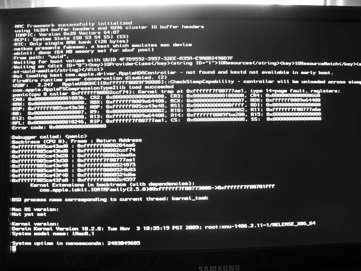

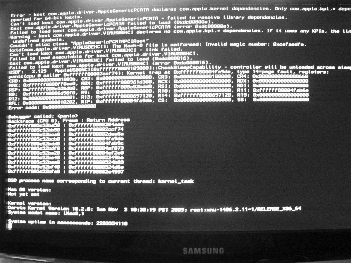

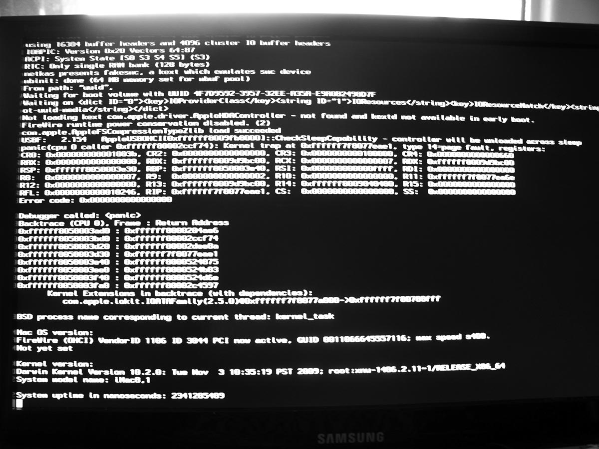

mikedddd Posted January 27, 2010 Author Share Posted January 27, 2010 Thanks for the response, its harder to take pics of your monitor than I'd thought, which is why I transcribed what I thought was the important part of the KP. If they're hard to read let me know and I'll work on my photography. I get a KP no matter how I boot. I've attached 3 images, the first is booting -v -f -x, the second -v, and the third -s. Thanks for any help. Mike Link to comment https://www.insanelymac.com/forum/topic/209228-working-1062-transfer-applications-kp/#findComment-1397389 Share on other sites More sharing options...
oldnapalm Posted January 27, 2010 Share Posted January 27, 2010 Do you see the messages about AppleGenericPCATA and VIAUSBEHCI? Looks like they are 32 bit kexts and may be the cause of the KP. Try removing them if you have a way to access the filesystem, or if you reinstall, list the kexts in your Extensions folder before restoring the backup, and remove the restored kexts before restarting the system. Before restoring the backup (in terminal): ls /System/Library/Extensions/ > ~/Desktop/before.txt After restoring the backup (but before restart): ls /System/Library/Extensions/ > ~/Desktop/after.txt diff ~/Desktop/before.txt ~/Desktop/after.txt Remove those kexts. EDIT: or make a backup of the Extensions folder before restoring the Time Machine backup, and after, restore the Extensions folder, looks like a plugin of IOATAFamily.kext is being replaced by Time Machine. Before TM restore: sudo cp -R /System/Library/Extensions /System/Library/Extensions.bak After TM restore: sudo mv /System/Library/Extensions /System/Library/Extensions.TM sudo mv /System/Library/Extensions.bak /System/Library/Extensions Link to comment https://www.insanelymac.com/forum/topic/209228-working-1062-transfer-applications-kp/#findComment-1397489 Share on other sites More sharing options...
