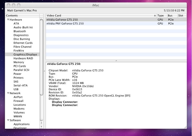

mg100796 Posted May 13, 2010 Author Share Posted May 13, 2010 UPDATE! I have successfully booted with BOTH cards regongnized. Problem is, is that I only get on display, no QE/QI, and it doesn't show any info on my second card besides it's name. (Check the screen shot below) This ONLY works if NVDAResman.kext is NOT loaded. If it is, then I get KP when it trys to switch to the GUI.... I think I'm really getting close, but still not quite close enough. I'm not sure what the problem is, but I would really like it if someone who knows what they're doing would look over my in.plist (Attached) and my GFX string (Attatched) and tell me if it's actually right so I know that's not the problem.. Many thanks for all this community has helped me!! GFXEFISTRINGS.zip Link to comment https://www.insanelymac.com/forum/topic/208367-dual-gts-250-kernal-panic/page/2/#findComment-1467859 Share on other sites More sharing options...
