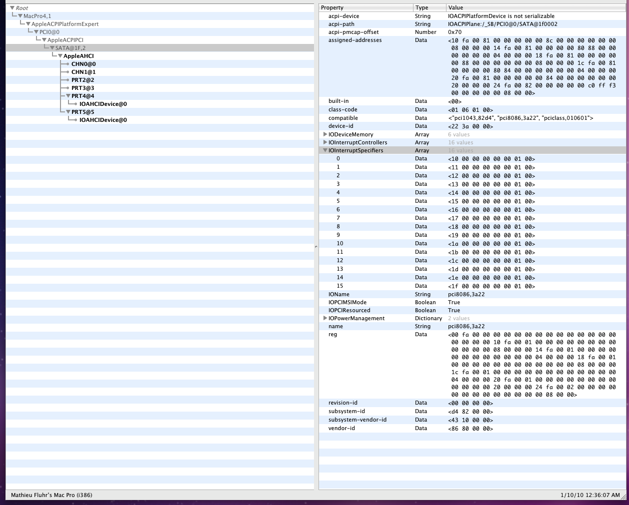

Guest Posted January 10, 2010 Share Posted January 10, 2010 Hello all, I tried to install Snow Leopard (retail) on the following configuration: - Core i7 920 (stock freq) - Asus Rampage II Extreme (bios 1639 - latest one) ...and just for info, I have some knowledges about system programming, but mostly under Linux. I don't claim to be an ACPI expert, but I also don't think being a total noob here . Let me first explain you my experiments: I have had a previous successful install of Leopard (using iAKTOS 7) with a DSDT.aml file that has been provided on their forum for bios 1504. As I was not so experienced with DSDT patching at this time, and as it was somehow working fine, everything was OK so far At that time, I was using Chameleon 1 as bootloader, w/o any specific smbios injections or boot directives. Then I tried to install snow on a external USB drive to see how it was reacting. My installation was the following: - Chameleon 2.0 RC4 - smbios.plist set to MacPro4,1 as model (attached) - the only additional kexts where fakesmc and NullCPUPowerManagement, both in the Extra subfolder. I then copied the DSDT.aml for the 1504 bios that I have had in the extra directory, and tried to boot... - With Leopard, the boot itself was taking ~20sec. In this case, more than 2min. - Some SATA drives where missing - All of then got the orange icon (seems to be normal, as I did not use the IOAHCIBlockInjector kext) First question here: Is this OK to use a DSDT.aml file created from another BIOS, or should I re-created one everytime I flash the MB with another BIOS revision ? Then I decided to remove the DSDT.aml and try to boot without, to get a clean one, using fassl's DSDT patcher and compare, to get a clue what was wrong. More or less the same. So no issue there (attached as dsdt_extreme_untouched). I then unplugged all my SATA devices and booted. Everything run fine this time! So I said to myself, there must be something wrong with the SATA part of the DSDT. As I am not an expert in this topic I was more experimenting than really knowing what I was doing there... but all the time with no luck. I then googled (mainly here) to see if some have had some issue. I found the Rampage II Gene topic from dgsga (http://www.insanelymac.com/forum/index.php?showtopic=201758), downloaded the DSDT.dsl (attached), compiled it using the lasted iasl compiler (20091214) and booted with... Guess what, problem fixed. Yeah, I know this is bad, but as the Rampage II Gene is more or less a Rampage II Extreme "light" this wasn't too risky. (NB: The file attached is slightly different from the one on the topic, as I took the liberty to add THeKing's slow SATA fix). Now the DSDT.dsl specific questions: After diffing the Gene DSDT and the clean one for my board, I found out some major differences: Both PR01 and AR01 have 1 more item I did not care about the ESI and HDEF device as I have disabled the HD Audio sound card The LPCB (named SBRG) was a little bit different. PS/2 devices and related methods (SIOH and _L1D) were not in the Gene DSDT.dsl Some hex values slightly differs in the CUPI and UMVS methods Some _DSM methods were added for devices (mainly USB) The SATA device was completly different (The one in the Gene seems to be based on the MacPro4,1 one) An SBUS method was added Some additional "sensors" (temp, voltage etc...) were not present in the Gene DSDT. I guess there are simply not present on the board itself... and finaly the _PTS and _WAK methods were lots more complicated in the Rampage DSDT After checking theses differences one by one, I found out that it was the PS/2 mouse methods that was the root of the issues. I checked the IRQ for the AHCI controller (looking at THeKiNG's post in http://www.insanelymac.com/forum/index.php...p;#entry1265443 both screenshots are attached) and attached the result with and w/o PS/2 mouse support (named dsdt_extreme_patched.dsl). The DSDT.dsl file that I found working, disabling the PS2M device (I know it is not (yet) optimized, but I like to know what I am doing is also attached. The changes that I have done: Eliminating any warning or remarks from the iasl compiler Adding THeKiNG's slow SATA fix Renaming the devices as much as possible to stick to the MacPro4,1 naming scheme Adding Darwin recogintion in the OSYS method Changed the OEMID and OEM table ID in the DefinitionBlock signature (also to stick with MacPro4,1) Commented out everything related to the PS/2 mouse. And finally, I remoed the NullCPUPowerManagement.kext, as I saw in some topics that when you have the right devices naming, the AppleCPUPowerManagement does not KP anymore (which is the case by the way). Some other thing to mention, is that with the attached DSDT, sleep seems to work correctly out of the box... but fails if NullCPUPowerManagment kext is loaded. I guess this is normal... Now the questionS: Why is a DSDT.aml file working with Leopard and failing with Snow? Am I missing some kexts, or is it just because the mach kernel handles devices differently? What is exactly the problem with the PS/2 mouse? I suspect a shared IRQ, but I am definitly not 100% sure What are exactly the PR01 and AR01 packages? Is this some king of PCI bus descriptors ? I saw in some topics that the device naming is important. Is this only related to the AppleCPUPowerManagement kext or has it more deeper implications ? Is the SATA device replacement done in the Gene DSDT somehow "safe"... I mean, are there no side effects? Once again, I am not an expert here, so I cannot even check what are the real differences. I guess the _DSM methods are to spoof the device IDs and make them recognized as apple ones? What is the SBUS device good for? Is this just to stick once again to MacPro4,1 ? The PutInSleep and WakeUp methods are rather simple in the Gene DSDT. As the "complicated" ones that I got in the original ones seems to work also, is it really a good idea to replaced them with the Gene ones ? If you are still reading this, I really thank you and appriciate that I really would like to get to know this DSDT stuff a little bit more, and would be gratefull if some of the local experts could answer the above questions and/or give me some hints on how to continue optimizations on the dsl file. I have read the post for the P5K (or P5Q I don't remeber...) in which Master Chief is doing an amazing job, but I have to admit that sometimes, the reasons of the modifications he is making are a little bit obscure for me Thanks in advance! M. smbios.plist.zip dsdt_rampage_gene.dsl.zip dsdt_extreme_untouched.dsl.zip dsdt_extreme_patched.dsl.zip Link to comment https://www.insanelymac.com/forum/topic/206553-some-questions-about-dsdt-patching-and-strange-conflict-with-ps2-mouse-and-ahci-on-rampage-ii-extreme/ Share on other sites More sharing options...
Guest Posted January 10, 2010 Share Posted January 10, 2010 Regarding the PS/2 mouse port issue, I am a little bit puzzled: The motherboard has only 1 PS/2 port on the rear panel connector. This connector is purple, so I guess it is a "keyboard only" connector. Quoting the Asus manual: PS/2 keyboard port (purple). This port is for a PS/2 keyboard. But in some tests they are saying something different: http://www.tweaktown.com/reviews/1662/asus...ard/index4.html Turning our attention to the rear I/O ports, ASUS has a fantastic layout and design. Of note here, there is only one PS/2 port, but it has a half purple and half green colour scheme. This is a dual purpose port; if you have a PS/2 mouse, you can run it off the PS/2 port and run the keyboard off the USB, or vice versa. If you have both a PS/2 keyboard and mouse, you’re stuffed here; it’s time to pick up a USB mouse/keyboard. I would definitly favor what is mentioned in the Asus motherboard... and this would be a possible explanation why it is causing problems... But then: - why the PS2M device appears in the DSDT ? - why with the same DSDT.aml file, leopard is working properly (all AHCI drives detected correctly) ? Link to comment https://www.insanelymac.com/forum/topic/206553-some-questions-about-dsdt-patching-and-strange-conflict-with-ps2-mouse-and-ahci-on-rampage-ii-extreme/#findComment-1381107 Share on other sites More sharing options...

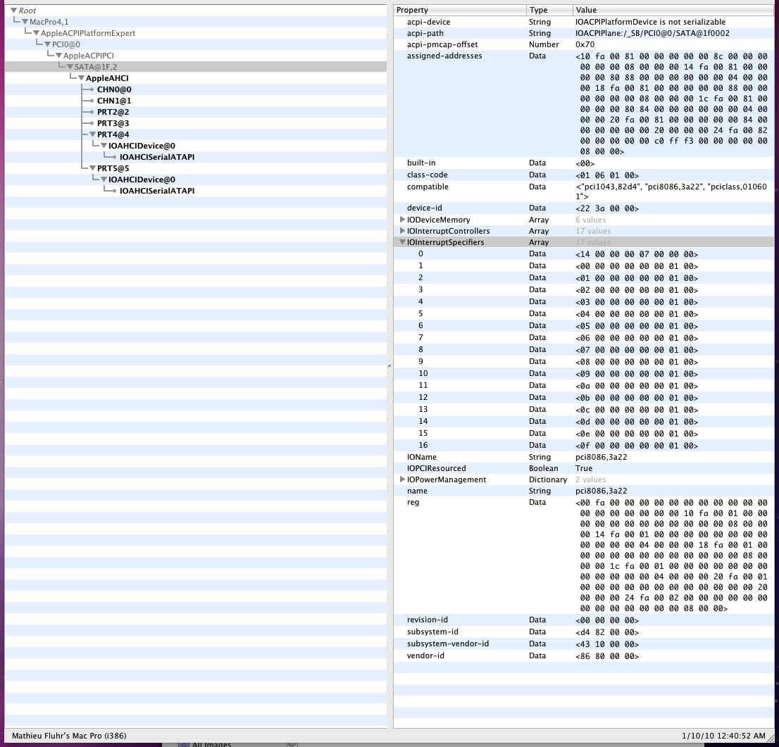

Detrich Posted January 21, 2010 Share Posted January 21, 2010 Hi, mathf I've made some fixes for RTC(changed to UTC and will not cause KP at boot), AHCI(removed orange icons), Device Localization(will improve better speed at start-up), fireware hot-plug(not tested), also added jMicron ID for native support(x32 only. because apple don't have x64 kext yet) and WakeUp Remote(_PRW) for some devices. Tell me, if it works for you. D. Rampage_II_Extreme_DSDT_RTC_Fix.zip Link to comment https://www.insanelymac.com/forum/topic/206553-some-questions-about-dsdt-patching-and-strange-conflict-with-ps2-mouse-and-ahci-on-rampage-ii-extreme/#findComment-1391886 Share on other sites More sharing options...
