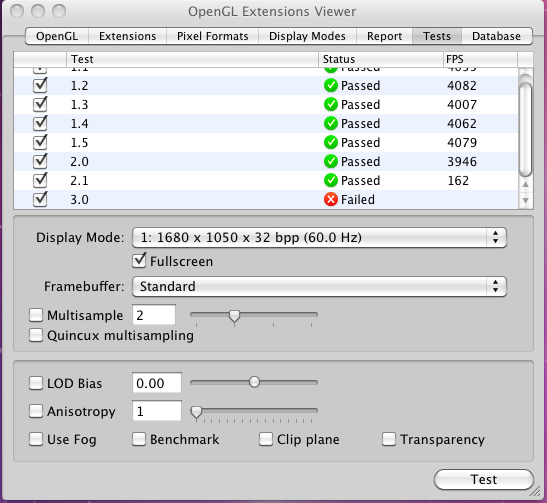

mrfrankmrfrank Posted January 3, 2010 Author Share Posted January 3, 2010 How about a screenshot of the working GTX 295? Sure! No problem! Any particular software you wish me to demonstrate its "workingness" via screenshot? In fact, I didn't know if you knew of any software that would let me know that both cores are in fact working successfully on the gtx 295 in mac. The way I consider the card working is because both screens work via dvi, and full 1080p playback is smooth as ice. Is there any way to further test the cards. I used xbench and got a decent score, but it didn't really tell me how many cores my gpu had and what not. Link to comment https://www.insanelymac.com/forum/topic/205329-ep45-ud3p-snow-leopard-with-gtx-295/page/2/#findComment-1375714 Share on other sites More sharing options...
Tristan Posted January 3, 2010 Share Posted January 3, 2010 Sure! No problem! Any particular software you wish me to demonstrate its "workingness" via screenshot? In fact, I didn't know if you knew of any software that would let me know that both cores are in fact working successfully on the gtx 295 in mac. The way I consider the card working is because both screens work via dvi, and full 1080p playback is smooth as ice. Is there any way to further test the cards. I used xbench and got a decent score, but it didn't really tell me how many cores my gpu had and what not. Try this benchmarking program: http://www.realtech-vr.com/glview/download.html and compare your results with others in the database. Here's my screenshot on another thread: http://www.insanelymac.com/forum/index.php...t&p=1374194 Link to comment https://www.insanelymac.com/forum/topic/205329-ep45-ud3p-snow-leopard-with-gtx-295/page/2/#findComment-1375732 Share on other sites More sharing options...
mrfrankmrfrank Posted January 3, 2010 Author Share Posted January 3, 2010 Try this benchmarking program: http://www.realtech-vr.com/glview/download.html and compare your results with others in the database. Here's my screenshot on another thread: http://www.insanelymac.com/forum/index.php...t&p=1374194 No problem. I'll check it out right after the bears game. Link to comment https://www.insanelymac.com/forum/topic/205329-ep45-ud3p-snow-leopard-with-gtx-295/page/2/#findComment-1375817 Share on other sites More sharing options...
mrfrankmrfrank Posted January 3, 2010 Author Share Posted January 3, 2010 i'm not quite sure why open gl 3.0 fails, any ideas? Link to comment https://www.insanelymac.com/forum/topic/205329-ep45-ud3p-snow-leopard-with-gtx-295/page/2/#findComment-1375999 Share on other sites More sharing options...
Tristan Posted January 3, 2010 Share Posted January 3, 2010 i'm not quite sure why open gl 3.0 fails, any ideas? Mine fails openGL 3.0 as well; am not sure why but it doesn't seem to affect performance though. Link to comment https://www.insanelymac.com/forum/topic/205329-ep45-ud3p-snow-leopard-with-gtx-295/page/2/#findComment-1376039 Share on other sites More sharing options...
