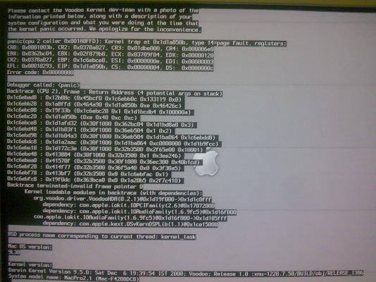

schizo_kid Posted December 22, 2009 Share Posted December 22, 2009 how to fix this?? im using ideneb 1.6 lite edition motherboard : asus m4n78 pro processor : amd phenom x3 710 can anyone help with this Link to comment https://www.insanelymac.com/forum/topic/203460-kernel-panicplz-help/ Share on other sites More sharing options...

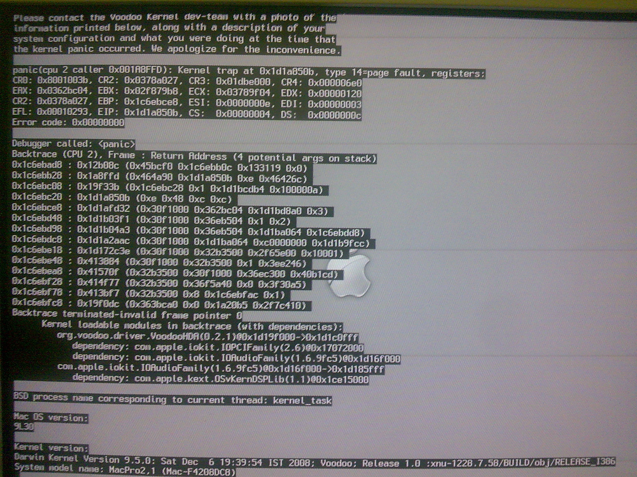

Beerkex'd Posted December 23, 2009 Share Posted December 23, 2009 Disable your on-board audio in the BIOS and try booting. If it boots, delete VoodooHDA.kext, as that's what's causing the panic (clearly visible in your screenshot). Remember to flush the caches as well. Link to comment https://www.insanelymac.com/forum/topic/203460-kernel-panicplz-help/#findComment-1366848 Share on other sites More sharing options...
schizo_kid Posted December 23, 2009 Author Share Posted December 23, 2009 Disable your on-board audio in the BIOS and try booting. If it boots, delete VoodooHDA.kext, as that's what's causing the panic (clearly visible in your screenshot).Remember to flush the caches as well. can u tell step by step how to do that? im a complete newbie here Link to comment https://www.insanelymac.com/forum/topic/203460-kernel-panicplz-help/#findComment-1366878 Share on other sites More sharing options...

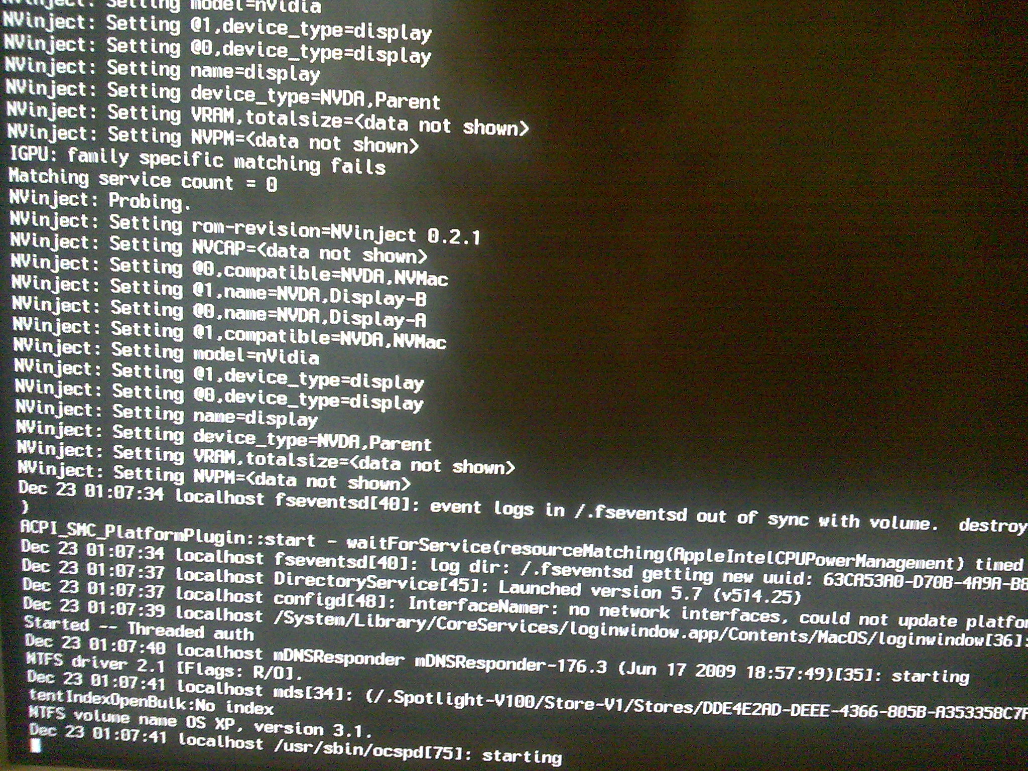

schizo_kid Posted December 23, 2009 Author Share Posted December 23, 2009 Your motherboard manual has a section in the back that details all the options in your BIOS and how to access it. Look up how to disable the on-board audio there. If you don't have a manual, you can download a .pdf copy from the manufacturer's website. after i disable the on-board audio it still cant boot, it stuck like the pic below on verbose mode Link to comment https://www.insanelymac.com/forum/topic/203460-kernel-panicplz-help/#findComment-1366898 Share on other sites More sharing options...
Beerkex'd Posted December 26, 2009 Share Posted December 26, 2009 You're very close, it's almost done booting at that point. Try booting with -v -x (-x is like 'safe mode' in Windows) and see if it goes any further. If it arrives at the desktop then it's probably something with the video drivers or the injection that isn't working. Link to comment https://www.insanelymac.com/forum/topic/203460-kernel-panicplz-help/#findComment-1369536 Share on other sites More sharing options...
