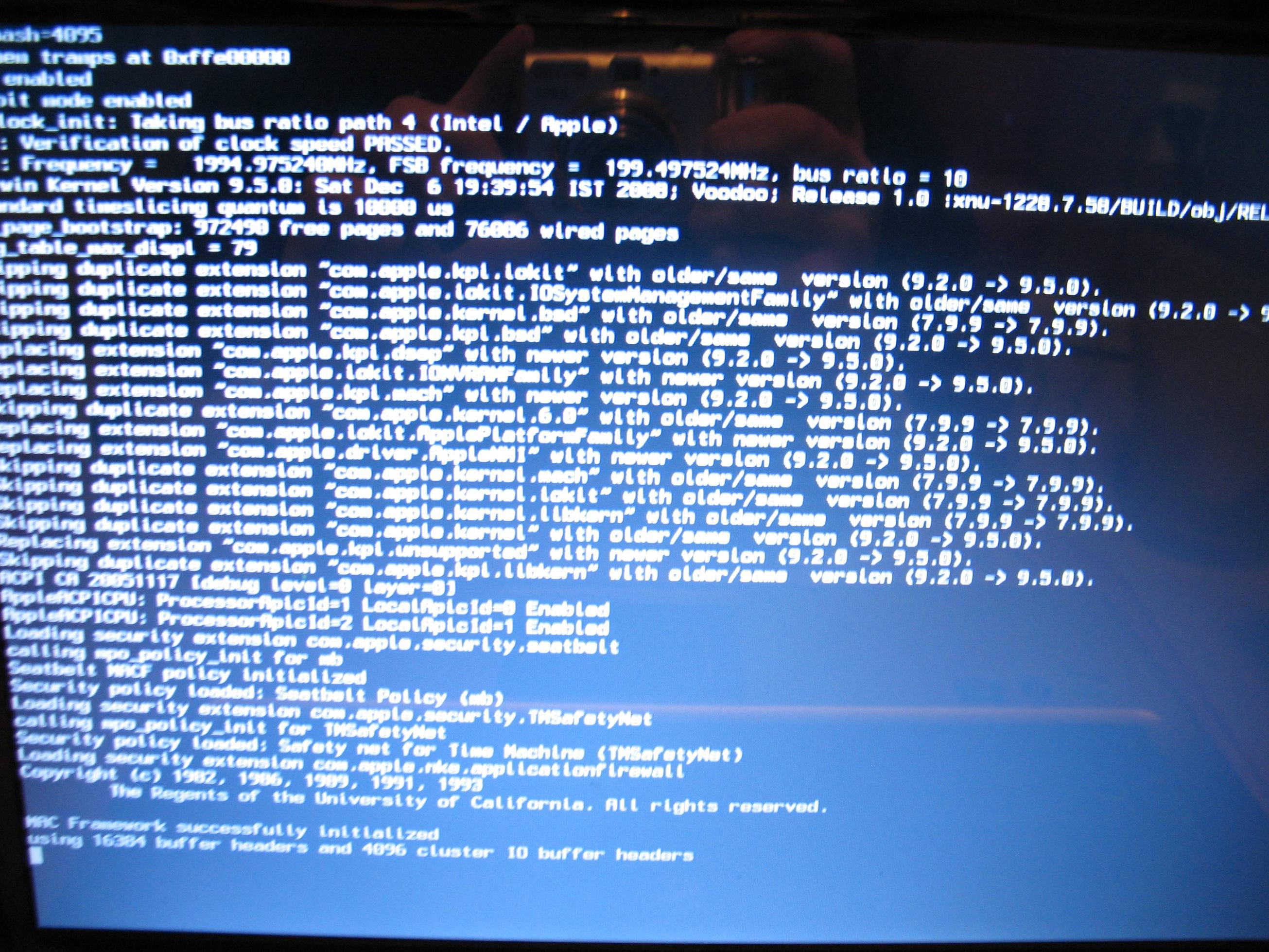

mike689 Posted November 12, 2009 Author Share Posted November 12, 2009 I was able to take a quick snapshot of the readout that happens with -v for a split second before it reboots It doesnt look as if it gets any errors, it just reboots. (Image attached) Link to comment https://www.insanelymac.com/forum/topic/197324-ipc-dvd-boot-issues/#findComment-1328862 Share on other sites More sharing options...
mike689 Posted November 12, 2009 Author Share Posted November 12, 2009 Well for anyone else that has this problem, i was able to fix it by booting with "-v cpus=1" thanks to zapf2000 on #OSx86 Link to comment https://www.insanelymac.com/forum/topic/197324-ipc-dvd-boot-issues/#findComment-1328909 Share on other sites More sharing options...
