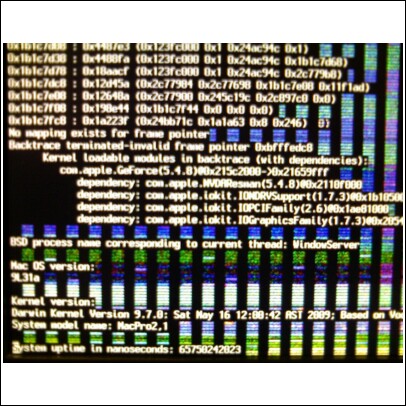

forcrz6 Posted November 2, 2009 Author Share Posted November 2, 2009 So again I tried the NVkush, and again I could not get it to run due to panics. Here are som Picturs of the Panic. Can anyone help? Link to comment https://www.insanelymac.com/forum/topic/194649-another-nvidia-8400-issue/#findComment-1317495 Share on other sites More sharing options...
