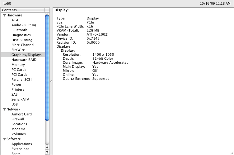

imrazor Posted October 16, 2009 Share Posted October 16, 2009 itjstagame, I went ahead and bought one of the Atheros adapters you linked to. Hopefully, it'll work better than the last one. At that price, it's not much of a loss if it doesn't. To see if the X1000 kext is loading, just go to a console and type "kextstat | grep -e X1000". You don't even have to be root. If it spits out a line like: 84 0 0x34a30000 0x5f000 0x5e000 com.apple.ATIRadeonX1000 (5.3.6) <77 76 17 12 6 5 4 2> then your hacked kext is loaded. You can also go to System Profiler, and look under Extensions to see what kexts are loaded. In System Profiler, you can also go to "Graphics/Displays" to see if Quartz Extreme and Core Image are enabled/accelerated. (See attachment) nhy, I'm not going to take a chance by zapping my BIOS with Zender's hacked copy. If I can get away with a $10 adapter off ebay, there's no point in taking a chance on bricking my T60. itjstagame got it working because it's a legit IBM/Lenovo part, and it's whitelisted in the original BIOS. Link to comment https://www.insanelymac.com/forum/topic/191357-snow-easy-install-to-thinkpad-t60-2623-dau/#findComment-1300675 Share on other sites More sharing options...
nhy Posted October 16, 2009 Share Posted October 16, 2009 imrazor I am not telling you to do zender bios fix I am only making you aware that if you get "error 1802" you will have no choice I hope you don't In my case one did it the other not In regard with what you told itjstagame is a good tool that help getting Quartz Extreme here PCWiz Computer - [Mac OSx86] OSx86 Tools Utility {New Final Release} Are you going to try the distro or the usb installer? I am trying the usb but I am getting problems installing Chameleon and that is only the begining. I also got an extra atheros at that price Link to comment https://www.insanelymac.com/forum/topic/191357-snow-easy-install-to-thinkpad-t60-2623-dau/#findComment-1300707 Share on other sites More sharing options...
