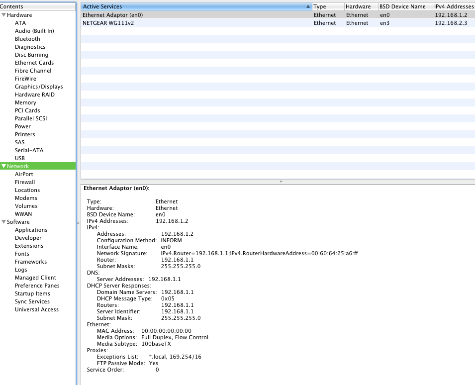

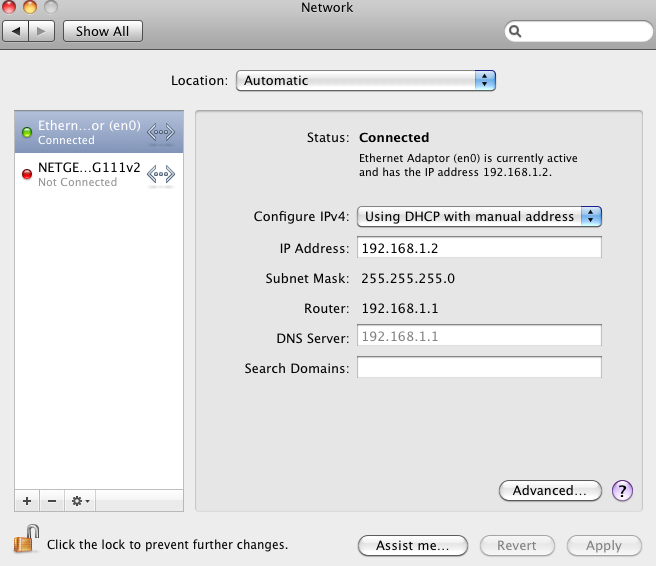

Gavanelli Posted August 24, 2010 Share Posted August 24, 2010 This is what I get: Ethernet Adaptor (en0): Type: Ethernet Hardware: Ethernet BSD Device Name: en0 IPv4 Addresses: 169.254.205.62 IPv4: Addresses: 169.254.205.62 Configuration Method: DHCP Interface Name: en0 Subnet Masks: 255.255.0.0 IPv6: Configuration Method: Automatic Ethernet: MAC Address: 00:00:00:00:00:00 Media Options: Full Duplex, Flow Control Media Subtype: 100baseTX Proxies: Exceptions List: *.local, 169.254/16 FTP Passive Mode: Yes Service Order: 0 I cant connect to the internet or anything on my network until I put in a mac address. Link to comment https://www.insanelymac.com/forum/topic/191179-dell-optiplex-gx520/page/4/#findComment-1536074 Share on other sites More sharing options...
Dellmantt Posted August 24, 2010 Share Posted August 24, 2010 This is what I get: Ethernet Adaptor (en0): Type: Ethernet Hardware: Ethernet BSD Device Name: en0 IPv4 Addresses: 169.254.205.62 IPv4: Addresses: 169.254.205.62 Configuration Method: DHCP Interface Name: en0 Subnet Masks: 255.255.0.0 IPv6: Configuration Method: Automatic Ethernet: MAC Address: 00:00:00:00:00:00 Media Options: Full Duplex, Flow Control Media Subtype: 100baseTX Proxies: Exceptions List: *.local, 169.254/16 FTP Passive Mode: Yes Service Order: 0 I cant connect to the internet or anything on my network until I put in a mac address. Have to say I am no expert on network Just trying to help Have you have tried putting a manual ip number? Link to comment https://www.insanelymac.com/forum/topic/191179-dell-optiplex-gx520/page/4/#findComment-1536077 Share on other sites More sharing options...
Gavanelli Posted August 24, 2010 Share Posted August 24, 2010 yep.. when I put it in manually I restart the modem\router and the internet works for a few seconds then everything goes offline again.. (mac address fault) Link to comment https://www.insanelymac.com/forum/topic/191179-dell-optiplex-gx520/page/4/#findComment-1536116 Share on other sites More sharing options...
Dellmantt Posted August 24, 2010 Share Posted August 24, 2010 yep.. when I put it in manually I restart the modem\router and the internet works for a few seconds then everything goes offline again.. (mac address fault) Sorry no idea Maybe somebody else will read this tread . One other thought, you said "the network" Only one computer (the hack) connected to the modem/router? Link to comment https://www.insanelymac.com/forum/topic/191179-dell-optiplex-gx520/page/4/#findComment-1536140 Share on other sites More sharing options...
Dellmantt Posted August 24, 2010 Share Posted August 24, 2010 OK MAC address--this works thanks to Kulos form this thread http://www.insanelymac.com/forum/index.php...40539&st=40 Quoting Kulos Download this: LaunchDaemons.zip and extract it. Enter the org.gizmolabs.setMAC folder and edit setmac.sh this line: /sbin/ifconfig en0 ether 05:14:21:5E:AE:A6 so it matches your correct MAC address. If you do not know your MAC address, you can use Linux to find out. Alternatively, make one up. I cannot promise it will work if you do not use your correct MAC address. Once saved, drop the folder and the plist into Library\LaunchDaemons and also into System\Library\LaunchDaemons Reboot your machine. You should find working internet. Link to comment https://www.insanelymac.com/forum/topic/191179-dell-optiplex-gx520/page/4/#findComment-1536555 Share on other sites More sharing options...
