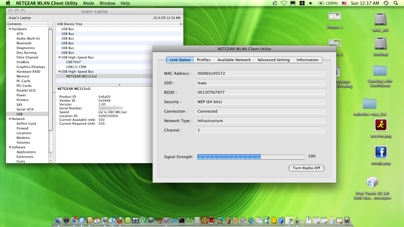

2o2 Posted October 1, 2009 Share Posted October 1, 2009 hmm maybe you should just get the drivers from netgears website, they have osx drivers for all of the wg111 usb adapters, i believe there are 3 different versions. just select urs and dl. im using the wg111v2 right now to type this Link to comment https://www.insanelymac.com/forum/topic/189786-netgear-wn111v2-help-needed-please/#findComment-1286137 Share on other sites More sharing options...

2o2 Posted October 4, 2009 Share Posted October 4, 2009 weird u have a different product id than i do. mine is also wg111v2 usb adapter and it works fine, no glitches ever Link to comment https://www.insanelymac.com/forum/topic/189786-netgear-wn111v2-help-needed-please/#findComment-1289104 Share on other sites More sharing options...
