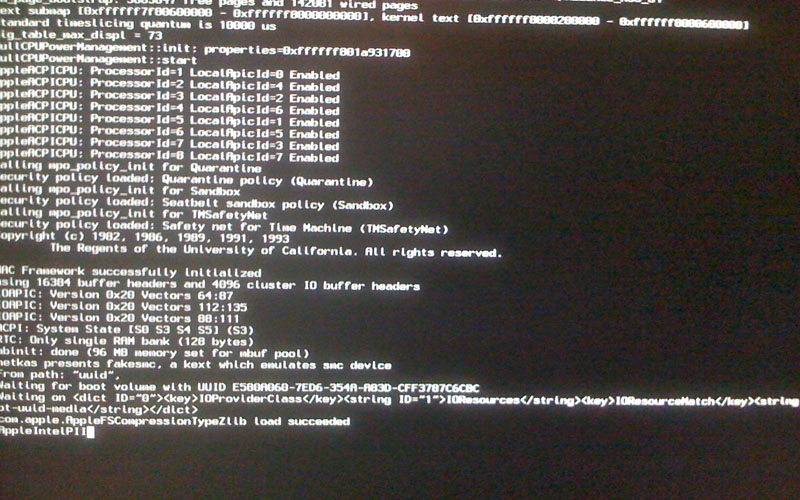

crazy drummer Posted October 23, 2009 Share Posted October 23, 2009 same here tried chameleon with 0) customized DSDT, 1) different combinations of kext, 2) latest boot file (since my 3870 has compability issue at boot), still no clue seems the problem is with IOATAFamily.kext, AppleIntelPIIXATA.kext (the point stuck in the log u posted, same for me) not 100% related to T7400, but i think sth relevant: http://www.insanelymac.com/forum/index.php?showtopic=187856 anyone passing by has some clue? Link to comment Share on other sites More sharing options...
vpvl66 Posted November 20, 2009 Share Posted November 20, 2009 ...http://www.insanelymac.com/forum/index.php?showtopic=187856 anyone passing by has some clue? I finally got it to work on my t7400! Here is what I had to do: 1) Patch DSDT pretty much as described above, only needed to make PIC and TMR changes. See attached. 2) Used standard Snow Leopard installation from that point on, with the following kext's in /Extra: AppleIntelPIIXATA.kext IOATAFamily.kext NullCPUPowerManagement.kext PlatformUUID.kext FramebufferDisabler.kext LegacyAppleRTC_32bit_Only.kext OpenHaltRestart.kext fakesmc.kext (IOATAFamily was very important) 3) For some reason I had to initially use Chameleon RC1 boot file, when creating Snow Leopard installation USB, but maybe this had to do with my Spinpoint HD. 4) Using pfix from conti was useful, as well as following instructions from prasys and aserebln. dsdt.zip Link to comment Share on other sites More sharing options...
