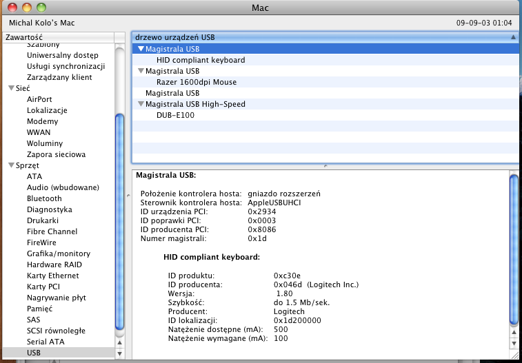

razvizion Posted September 1, 2009 Share Posted September 1, 2009 Like in the title GFX -QE/CI works(no string, patched DSDT) and audio whitout Mic, but: speakers, line out/in works. Ethernet on USB (Dell DUB-E100) and replaced WiFi (Dell DW 1390). I've used chameleon v1012, kexts and modified boot file from teknojunkie's tutorial and netkas fix for USB, modified appleHDA from gigabyte mobo and DSDT from ugokind tutorial (udoking You are big! THX for that guide). I still try to figure out how to make that internal camera work. Link to comment https://www.insanelymac.com/forum/topic/183432-snow-leopard-on-acer-aspire-5930g/ Share on other sites More sharing options...

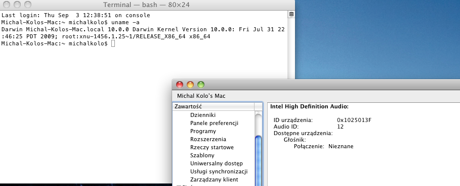

razvizion Posted September 3, 2009 Author Share Posted September 3, 2009 There is no other way to repair caches believe me I've tried all other methods. You are brave using ntsf drivers like ntfs-3g or paragon may only erase your data on ntfs partition, be careful. I read this on other osx forum So... better to delete the disabler ? ... Edit - I've deleted it and still working , but the audio is freaking me off :/ now when snow is booting in 32 and 64(Camera works) normally I don't have any audio. This is what i get under -x64 and -x32 : Link to comment https://www.insanelymac.com/forum/topic/183432-snow-leopard-on-acer-aspire-5930g/#findComment-1249275 Share on other sites More sharing options...

razvizion Posted September 3, 2009 Author Share Posted September 3, 2009 So I get my audio back, how ? Weird, I've deleted the HDAenabler.kext from that patched AppleHDA and putted into extra/extensions folder, patched appleHDA.kext without enabler into library/extension. Oh and my IOUSBFamily is an original vanilla with netkas fix (Safe Boot) no other mods to prevent from hangs on boot. For this boot i have my Acer camera and audio... but for how long ;/ And how i transformed "line in" into a "mic in" as You may know Line In don't have an AMP. Megaphone app for iPhone solved that with a jack-jack cable. Link to comment https://www.insanelymac.com/forum/topic/183432-snow-leopard-on-acer-aspire-5930g/#findComment-1249688 Share on other sites More sharing options...
Hugo_bee Posted September 3, 2009 Share Posted September 3, 2009 ok i never understood the fact to reset my boot stops.. using -x -x32 one time yes it's running thanks now.. rebooting normally.. all is fine i've tested your appleps2controller+ps2nub.. ok but removing hdaenabler and voodoohda and put acer888s and applehda inside your package.. no soud.. all is grey I use (as I wrote) no disabler, no nullcpu and I suppose that your iousbfamily is equal to mine.. = retail snow iousb + netkas mod. camera is ok. bye Link to comment https://www.insanelymac.com/forum/topic/183432-snow-leopard-on-acer-aspire-5930g/#findComment-1250063 Share on other sites More sharing options...
razvizion Posted September 3, 2009 Author Share Posted September 3, 2009 Sorry to fast I'm running on 32 bit mode so i think that is why i get sound this method. All kext that are connected whit sound I've used: 1. Your DSDT in root 2. AcerALC in Extra 3. HDAEnabler in Extra, that i cut off from AppleHDA - gigabyte mobo thread in first post 4. AppleHDA in library/extensions - gigabyte mobo thread in first post I didn't used voodoo PS. If You have DSDT without sound injection I will be glad to have it and test with voodooHDA I'm gray in changing modding this DSDT tables. Link to comment https://www.insanelymac.com/forum/topic/183432-snow-leopard-on-acer-aspire-5930g/#findComment-1250141 Share on other sites More sharing options...
