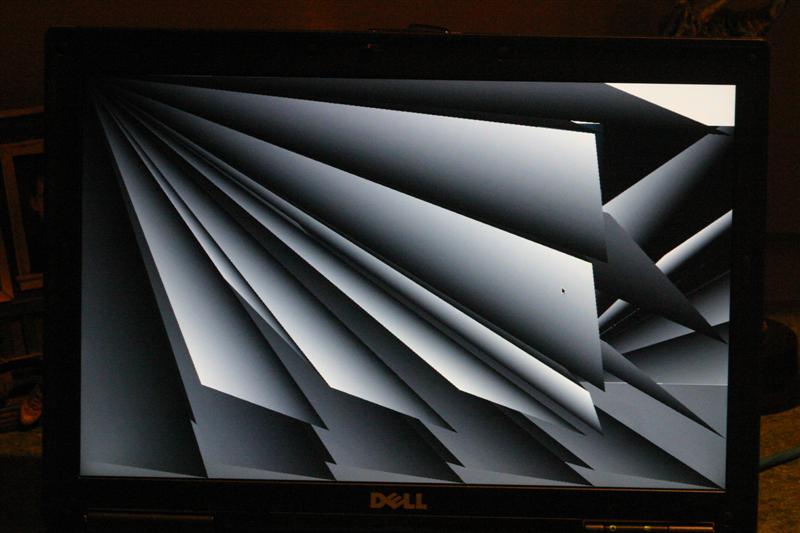

I Have a Dell Latitude D620 notebook with Intel Core Duo processor and Intel 945GM Express Chipset Graphics. I installed Windows XP Professiional in the first partition, then OS X 10.4.6 in a second partition following instructions on this site. Everything went fine during the instalation of OS X. I used chain0 to select the OS X partition at boot. However when I boot OS X I get the following error message:

I found that if I specify Platform=X86PC in the boot options, I am able to get past the Kernal Panic. It now appears to boot up into OS X, However I can't read anything on the screen. The screen shows diagonal Poligons from the top left of the screen to the bottom right of the screen. There is also a smaller window open in the middle of the screen that also has these same diagonal polygons, except that at the bottom of the center window, there is a white rectangle.
I am guessing that my Intel 945GM Express Chipset Graphics are not being handled properly. Does anyone else have any experience with this chipset? Is there any way to get around the problem?

Thanks for the post. I made the BIOS change you suggested and it DID resolve the panic error I was originally getting so I no longer have to specify "Platform=X86PC" at boot. However I still get the strange video display that I described in my first post under the ***** UPDATE ***** section.
Do you have any ideas about that problem?
Thanks!
btw - I have attached a picture of the screen when OS X boots so you can see exactly what it looks like.post-40523-1148513390_thumb.jpg
In the extra options in the install selecting you need to turn of the Intel GMA 900 Video Drivers. I assume you didn't customize the installation.
You only need the the OS X 10.4.6 Patch, Intel SSE2, SSE3, and the VIA Sata Support
Thanks - that worked for me too! The laptop has Intel Graphics Media Accelorator 950, I guess the 900 isn't compatible.

I'm getting the same wierd display screen on my dell e1505. I can boot just fine with -x, but not normally.
