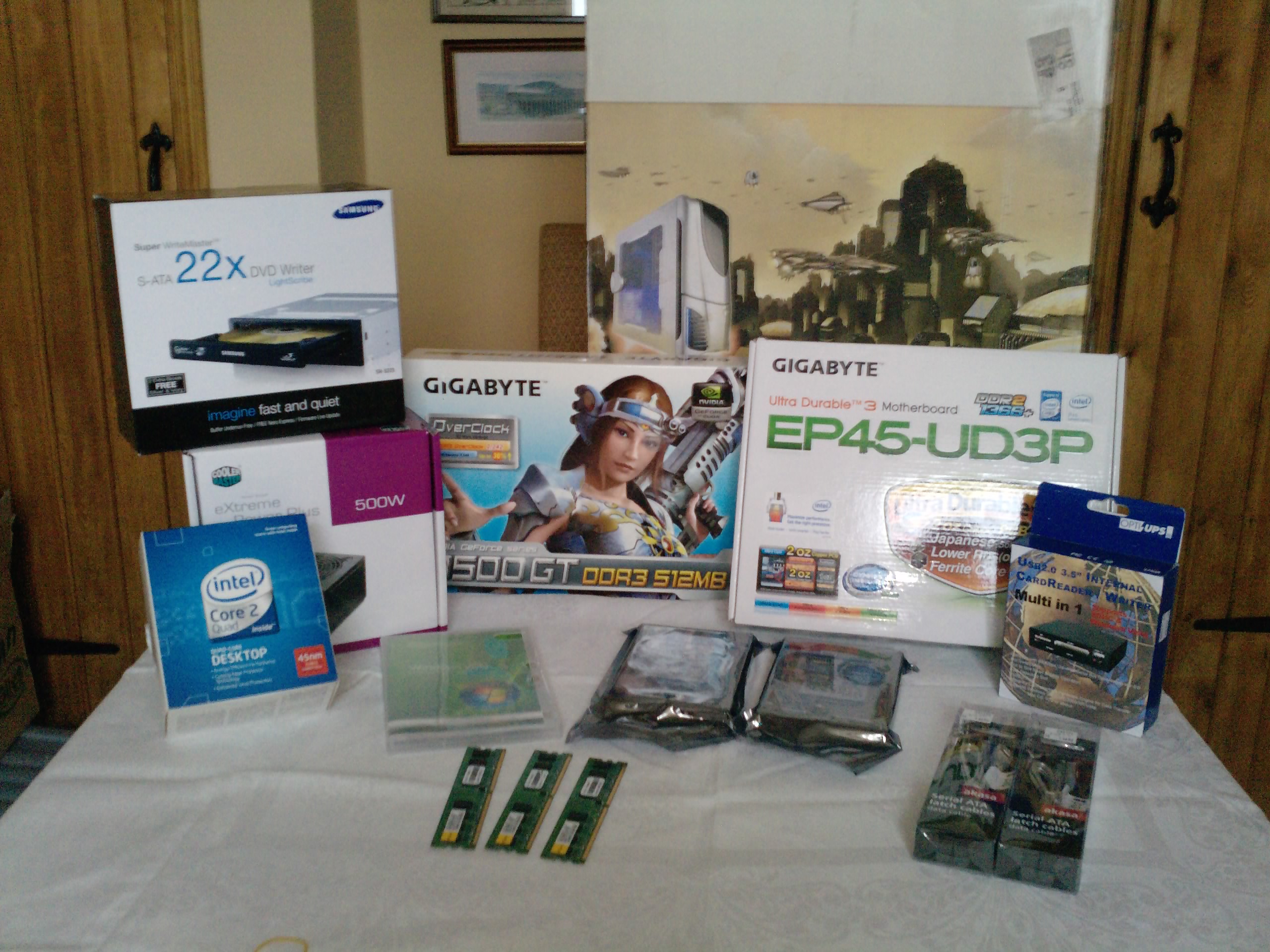

ainsleyclark Posted August 28, 2009 Share Posted August 28, 2009 Hi there, Upon realizing (about 6 months ago) it was possible to install a Mac Operating System on to a Windows Hardware based PC, I wet myself (not literally). I installed Leo4All V1 on my HP Pavillion DV6000, which was a success but the only thing that didn't work was the graphics card or the built in audio. Requiring a good PC with OSX on it, for university, I decided to order all my parts with the advice of a few friendly people on the forums (big thanks to broken). Any enough rambling... I plan to dual boot OSX Lepoard 10.5.6 with Windows Vista Home Premium (64-bit and Windows 7 when it gets released properly) with two 500GB Hardrives, using boot-132. Here is my spec: From left to right, top to bottom. 1 x Samsung 22x DVD±RW SATA Dual Layer Lightscribe ReWriter Black. 1 x Coolermaster 500W Extreme PSU with 12cm. 1 x Intel Core 2 Quad Q9550 Quad Core CPU 2.83GHz L2 Cache 12MB 1333MHz LGA775. 1 x Gigabyte 9500GT SLI 512MB GDDR2 PCI-E DVI. 1 x Microsoft Windows Vista Home Premium 64Bit OEM with Windows 7 upgrade voucher. 3 x ELIXIR memory 2GB DDR2 800 PC6400 RAM. 1 x NZXT Case Apollo black ATX midi tower NO PSU. 1 x Gigabyte GA-EP45-UD3P Ultra Durable 3 Motherboard (P45 Express Chipset). 2 x Western Digital 500GB hard disk drive Caviar SE16 SATA II 300 7200rpm 16MB. 1 x Opti-ups Internal Card Reader UCR36IN1B USB2.0 BLK for CF/SD/MS/Micro 2 x Akasa SATA II Silver HDD cable with Secure Latch @ £3.02(0.45) each. My friend is coming over any minute to give me a hand. Please feel free to give me some advice I will keep you updated. Ains! Link to comment https://www.insanelymac.com/forum/topic/182293-building-installation-of-my-first-hack/ Share on other sites More sharing options...

ainsleyclark Posted September 4, 2009 Author Share Posted September 4, 2009 Hey there, I built it fine and all went well, I followed a couple of guides, one was this one, http://auzigog.com/2008/12/23/hackintosh-20/:, which I didnt have success with, the main reason was I was trying to install chameleon then install pc efi. This didnt work so I followed weaksauces guide. https://leopardsoup.pbworks.com/session/log..._page=FrontPage which was amazing, I booted the disc then installed Mac OSX. Reebooted skipted instillation, now I have everything working, absoutley everything out of the box. The main reason I bought the board was because I knew it was so compatiable. Quad core, 6 gigs of ram is recognized running at 2.83ghz (havent overclocked) I only have 3 issues, if anyone could help it would be greatley appricated. 1) Sometimes (I think its when I dont shut down properly) I get still waiting for root device, this only happens unoccisaley. 2) When I boot in to mac, shut down then go into windows I get crappy screen res, I have to switch manually (happens sometimes). 3) I have tried flashing the bios to a different version but sometimes my bios gets stuck on the boot screen and doesent do anything. I assure you, this board is incredible, and has been a breeze to install. Here is the link about the board : http://www.insanelymac.com/forum/index.php...p;#entry1239076 Thanks Link to comment https://www.insanelymac.com/forum/topic/182293-building-installation-of-my-first-hack/#findComment-1251724 Share on other sites More sharing options...
