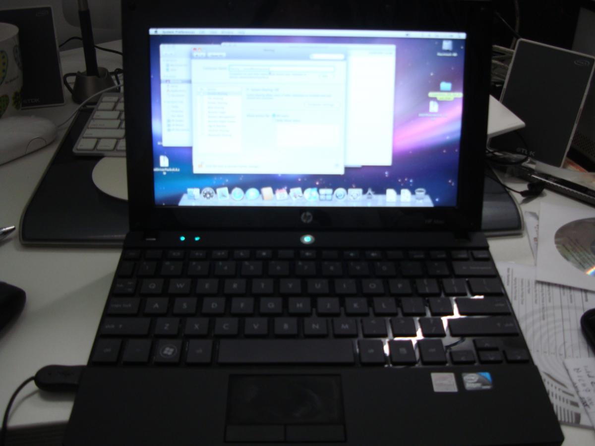

Terrancio Posted November 5, 2010 Share Posted November 5, 2010 this seems to be the closest anyone has got so far:http://myhpmini.com/forum/viewtopic.php?f=17&t=2070 see if it helps out! HP mini 5101 iPC 10.5.6 restore on 8gb usb flashdrive (Boot132 1gb usb drive) basic installation (really quick) rebooted ran Netbookinstaller 0.8.3 all except bluetooth fix, because it was working repaired permissions/restarted still no video, so i used kext helper to put: AppleIntelgma950.kext AppleIntelGMA950ga.plugin AppleintelGma950glDriver.bundle AppleintelGma950VADriver.bundle AppleIntelintegratedFramebuffer.kext Natit.kext as for sound just install Azalia.pkg off the iPc dvd installation packages, i could've done it in the initial Custom installation, but i wanted to make sure... and now i have a nice working machine, except for wireless and ethernet... on the wifi side, how about installing a mini pcie other than broadcom, like an Atheros, even if its not half size... have anyone tried making it fit? thanks, Cheers! Link to comment https://www.insanelymac.com/forum/topic/180635-retail-1056-on-hp-mini-5101/#findComment-1577057 Share on other sites More sharing options...
