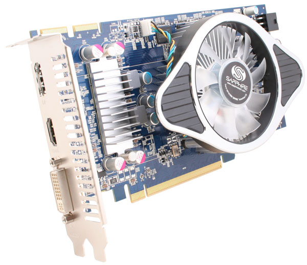

crunchattak59 Posted August 19, 2009 Share Posted August 19, 2009 Hi drumthrasher109, Welcome in my wolrd... I have try all Tuto for 4850 (in 10.5.6, 10.5.7 and 10.5.8). And none do not work! Because I think my graphic card is "exotic" I have 1 DVI, 1HDMI and 1 displayPort. The only thing I managed to do: QE ok CI software supported, and my ATI is 512Mo. But Mac os find 256Mo. So Good luck to find a soluce... Do you have try this: http://www.insanelymac.com/forum/index.php?showtopic=167977 ? Here is my Graphic Card Crunch. Link to comment https://www.insanelymac.com/forum/topic/179939-4850-problems-getting-pissed-off/#findComment-1229844 Share on other sites More sharing options...

torifile Posted August 20, 2009 Share Posted August 20, 2009 Hi drumthrasher109, Welcome in my wolrd... I have try all Tuto for 4850 (in 10.5.6, 10.5.7 and 10.5.8). And none do not work! Because I think my graphic card is "exotic" I have 1 DVI, 1HDMI and 1 displayPort. The only thing I managed to do: QE ok CI software supported, and my ATI is 512Mo. But Mac os find 256Mo. So Good luck to find a soluce... Do you have try this: http://www.insanelymac.com/forum/index.php?showtopic=167977 ? Here is my Graphic Card Crunch. I have the same type video card and the same problems as described in this thread. I've got the 4870 with a DVI, HDMI and Displayport. No go with any of the aforementioned fixes. I think this card is a dud for a Hackintosh. Link to comment https://www.insanelymac.com/forum/topic/179939-4850-problems-getting-pissed-off/#findComment-1230722 Share on other sites More sharing options...
crunchattak59 Posted August 20, 2009 Share Posted August 20, 2009 Yes me too I have buy today a NVIDIA 9600GT... In 5 secondes it is installed on my hackintosh. I think in the futur never buy a ati... Good luck. Crunch. Link to comment https://www.insanelymac.com/forum/topic/179939-4850-problems-getting-pissed-off/#findComment-1230785 Share on other sites More sharing options...
