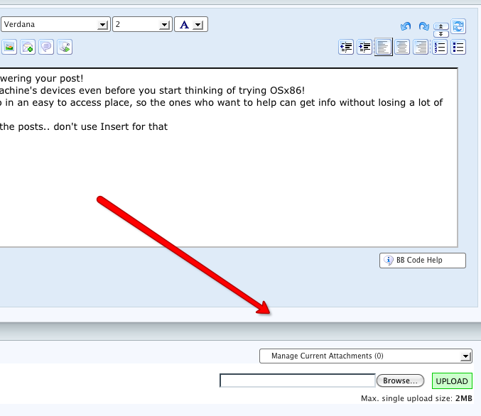

Azimutz Posted July 24, 2009 Share Posted July 24, 2009 hey.. i'm starting to regret answering your post! First, you should know your machine's devices even before you start thinking of trying OSx86! Then you should have that info in an easy to access place, so the ones who want to help can get info without losing a lot of time. And you can attach images to the posts.. don't use Insert for that. (check the pic) And what about select/copy/paste what asked you from the app?? Link to comment https://www.insanelymac.com/forum/topic/176344-internet-not-working-after-succesfull-install-of-1057/#findComment-1208154 Share on other sites More sharing options...

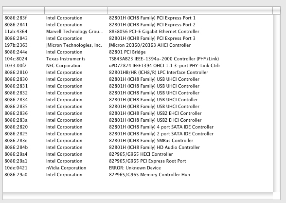

boomboxxsocks Posted July 24, 2009 Author Share Posted July 24, 2009 yo. i've sent you a private message, as i want to send you a image and it only lets you use urls for images here rather than attachments. B. ah soz didn't see that. i've been on OSx86 since jan 2008. and upgraded to 10.5.7 this morning due to the release of logic 9, which looks awesome. like i say everything is working just not the ethernet lan port. i've attached my screen shot. B. ah soz didn't see that. i've been on OSx86 since jan 2008. and upgraded to 10.5.7 this morning due to the release of logic 9, which looks awesome. like i say everything is working just not the ethernet lan port. i've attached my screen shot. B. attachment here, i hate PCs! Link to comment https://www.insanelymac.com/forum/topic/176344-internet-not-working-after-succesfull-install-of-1057/#findComment-1208162 Share on other sites More sharing options...
Azimutz Posted July 24, 2009 Share Posted July 24, 2009 Ok.. had to do a little research. Try installing the attachment but, don't forget to backup the existing IONetworkingFamily.kext. If it works i'll explain it to you later... Edit: removed attachment Link to comment https://www.insanelymac.com/forum/topic/176344-internet-not-working-after-succesfull-install-of-1057/#findComment-1208205 Share on other sites More sharing options...
boomboxxsocks Posted July 24, 2009 Author Share Posted July 24, 2009 Ok.. had to do a little research. Try installing the attachment but, don't forget to backup the existing IONetworkingFamily.kext. If it works i'll explain it to you later... hi thanks for that. i installed and repaired permissions then restarted and still no network (ethernet). thoughts? B. Link to comment https://www.insanelymac.com/forum/topic/176344-internet-not-working-after-succesfull-install-of-1057/#findComment-1208276 Share on other sites More sharing options...
Azimutz Posted July 24, 2009 Share Posted July 24, 2009 Hum.. did you deleted kext cache (S/L/Extensions.mkext)? if not, try that. System should rebuild it when you install a kext but, you never know. I'm not familiar whit your ethernet card so, if deleting the cache doesn't work look in this topic.. Your card is a Marvell Yukon 88E8056, vendor 11ab, device id 4364. What i did was edit the info.plist inside AppleYukon2.kext (inside IONetworkingFamily).. replaced the device id in 88E8055 to match yours but, i don't know if something else needs editing?! Did you had any fix installed for it before the update? Edit: also try loading the kext from Extra folder. You need a bootloader with Extra folder support.. Chameleon2. Edit: try this attachment.. i did some changes after reading a bit more on that topic. Here is another topic with info... IONetworkingFamily.kext.zip Link to comment https://www.insanelymac.com/forum/topic/176344-internet-not-working-after-succesfull-install-of-1057/#findComment-1208310 Share on other sites More sharing options...
boomboxxsocks Posted July 27, 2009 Author Share Posted July 27, 2009 Hum.. did you deleted kext cache (S/L/Extensions.mkext)? if not, try that. System should rebuild it when you install a kext but, you never know.I'm not familiar whit your ethernet card so, if deleting the cache doesn't work look in this topic.. Your card is a Marvell Yukon 88E8056, vendor 11ab, device id 4364. What i did was edit the info.plist inside AppleYukon2.kext (inside IONetworkingFamily).. replaced the device id in 88E8055 to match yours but, i don't know if something else needs editing?! Did you had any fix installed for it before the update? Edit: also try loading the kext from Extra folder. You need a bootloader with Extra folder support.. Chameleon2. Edit: try this attachment.. i did some changes after reading a bit more on that topic. Here is another topic with info... hi thanks for all your help. i took you modified kext then edited it with that topic and my internet is now working. thanks again. Boom! Link to comment https://www.insanelymac.com/forum/topic/176344-internet-not-working-after-succesfull-install-of-1057/#findComment-1210110 Share on other sites More sharing options...
