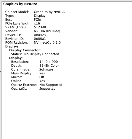

chris_lowe2 Posted July 13, 2009 Share Posted July 13, 2009 Ok here goes after reading 100's of fixes over the last day I am at my Wits End. I have an HP Pavillion DV9700 running osX86 10.5.6 Final Here is the install Default Kernal 9.6.0 ICHx SATA Drivers Seatbelt.kext Ethernet Realtek R1000 Legacy Time Machine Fix Video- NVinject 0.2.0 (I have NVinject 0.2.1 512MB Vram, but after reboot it changes) Audio- ALC2628 USB Patched USB Drivers Power Power Management Package Shutdown Restart Fix I also installed a few applications that I have used in the past. Now for the computer Graphics Nvidia GeoForce 8600M GS 512MB Intel® Core 2 DUO PU TS450@ 1.66GHZ What I want to know is if this video card can have quartz extreme? I have looked through the posts and I have tried a million different things and I still can't figure it out. This will solve 99% of the issues that I am having with my programs from what I have read. If it can not support QE and there is no fix, can you recommend a card for this computer. I want Quartz Extreme. I am including a screen shot for the graphics, so you know what I have installed. Also I have a RICOH card reader that I would like to get working as well. My main concern is the Quartz. If I cant enable it, then I want a new card. I am fairly new to this forum, but I have successfully installed this twice with a few tweaks. If you provide fixes, that require changing system files, or updates, please provide step by step or link to a tutorial. Also I have searched through every site out there and can not find a solution that works for me, thus the reason for this post. So please don't tell me to search it is there, I have run out of search. Thanks for the assistance and the great product. By the way I have updated to 10.5.7 successfully. Chris Graphics by NVIDIA: Chipset Model: Graphics by NVIDIA Type: Display Bus: PCIe PCIe Lane Width: x16 VRAM (Total): 512 MB Vendor: NVIDIA (0x10de) Device ID: 0x0425 Revision ID: 0x00a1 ROM Revision: NVinjectGo 0.2.0 Displays: Display Connector: Status: No Display Connected Display: Resolution: 1440 x 900 Depth: 32-Bit Color Core Image: Software Main Display: Yes Mirror: Off Online: Yes Quartz Extreme: Not Supported QuartzGL: Supported Link to comment https://www.insanelymac.com/forum/topic/174736-hp-pavillion-dv9700-0sx86-1056-final-issues/ Share on other sites More sharing options...
chris_lowe2 Posted July 17, 2009 Author Share Posted July 17, 2009 In case anyone else is having this issue, I finally got the problem fixed. The graphics issue was causing me not to be able to use iLife 09 and iWork 09, because of Quartz extreme. I uninstalled NVinject.kxt and extracted NVDarwin 512mb from the osX86 disc and installed it. Rebooted and now QE is supported and I can use all of the programs. Chris Link to comment https://www.insanelymac.com/forum/topic/174736-hp-pavillion-dv9700-0sx86-1056-final-issues/#findComment-1202437 Share on other sites More sharing options...
