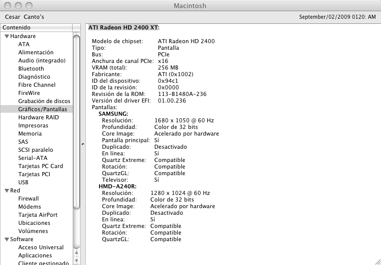

cesar1964 Posted August 29, 2009 Share Posted August 29, 2009 GRACIAS trabaja muy bien Link to comment https://www.insanelymac.com/forum/topic/171422-ati-radeon-hd-2400-xt-on-dell-optiplex-755/#findComment-1241308 Share on other sites More sharing options...
