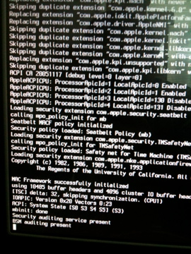

GPL_Happy Posted September 26, 2009 Share Posted September 26, 2009 Hello, I'm a new user here and I have some trouble to install iPC 10.5.6 on my DG33BU board. So, this is the hardware used: - Intel DG33BU motherboard - Integrated video adapter based on Intel GMA 3100 - SATA Hard Drive - SATA CD/DVD ROM Drive The system boot regularly from the Install DVD, than I proceed with the "-v" option to a verbose installation. After some seconds the system "freeze" on an waiting message. Here I attach a picture of the "error" (sorry for the flash in the middle of the screen). The BIOS is set as: ATA/IDE mode: Native Configure SATA as: AHCI SMART: Enable What can I do to solve this error ? (Excuse me for the bad English) Thanks. Edit: Same happens with a IDE CD/DVD ROM Drive Link to comment https://www.insanelymac.com/forum/topic/169167-ipc-successfully-installed-on-intel-dg33bu-and-xfx-geforce-8500-gt/#findComment-1281215 Share on other sites More sharing options...

Gautham Gupta Posted October 7, 2009 Share Posted October 7, 2009 Hey This is Gautham from the Snow Leopard thread. I tried installing iPC Mac OS X 10.5.6 according to your guide. I get the same problem as GPL_Happy except the two "can't determine..." lines under the ACPI System State line. I am stuck at the same "Waiting on <dict ID=8>..." line. Link to comment https://www.insanelymac.com/forum/topic/169167-ipc-successfully-installed-on-intel-dg33bu-and-xfx-geforce-8500-gt/#findComment-1292593 Share on other sites More sharing options...

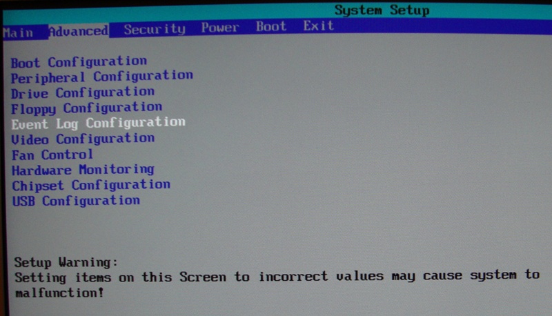

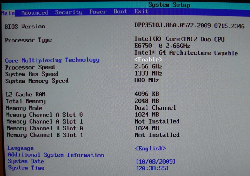

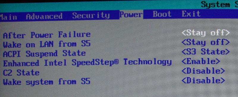

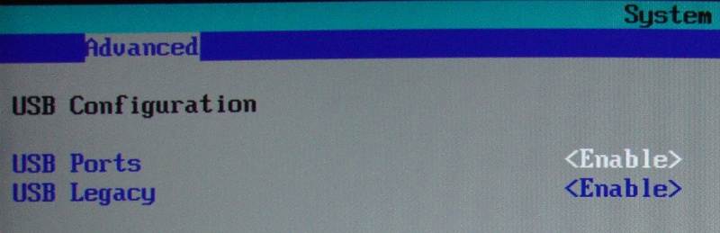

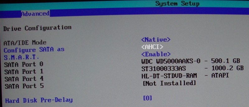

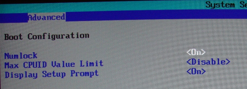

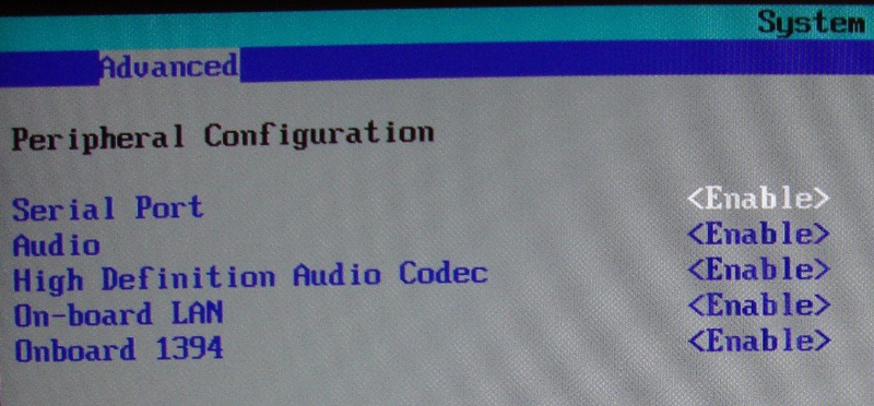

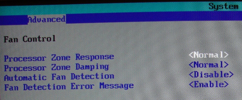

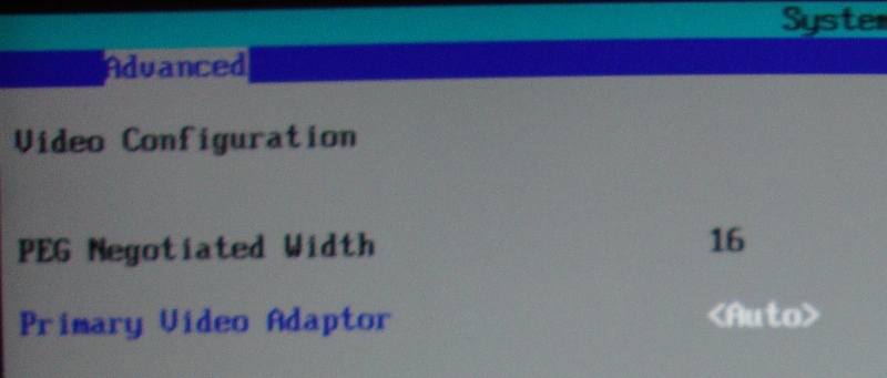

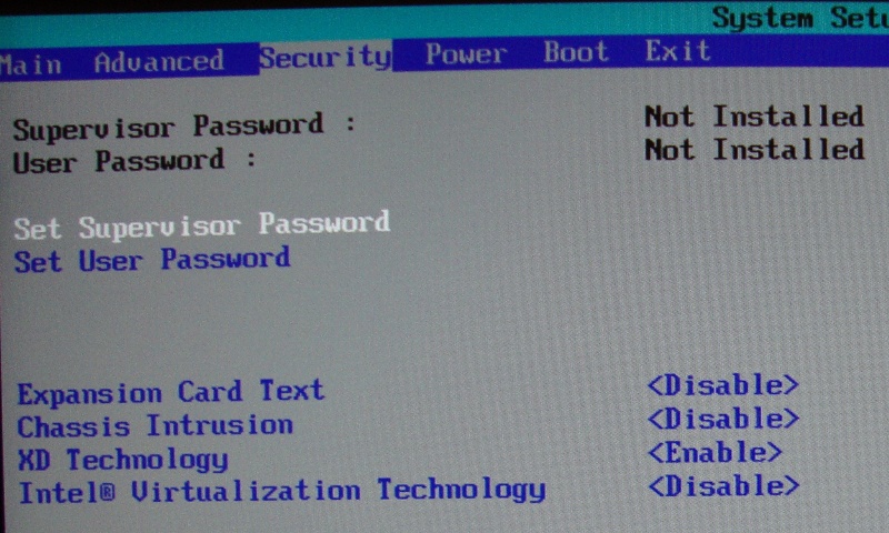

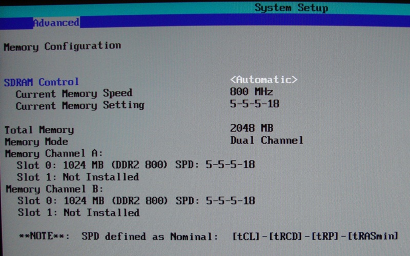

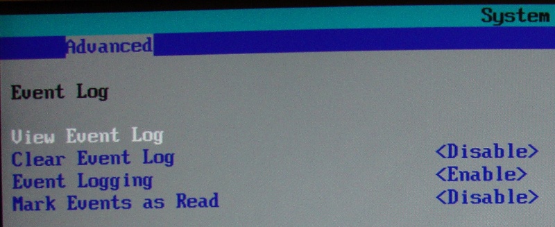

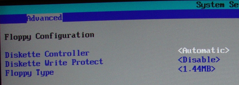

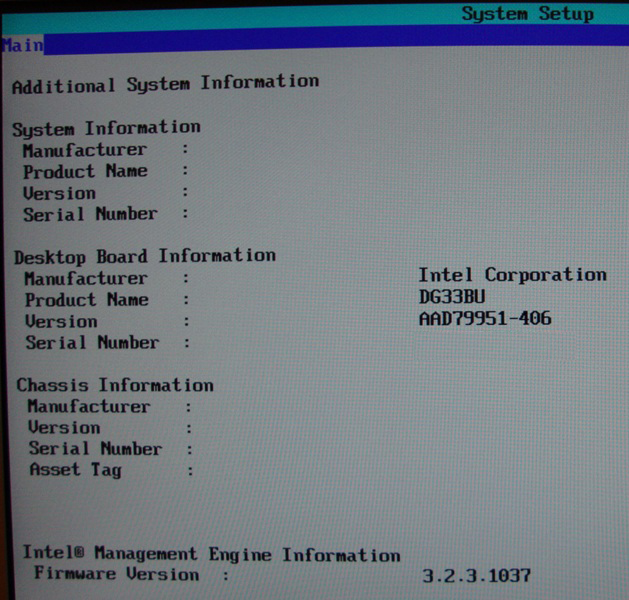

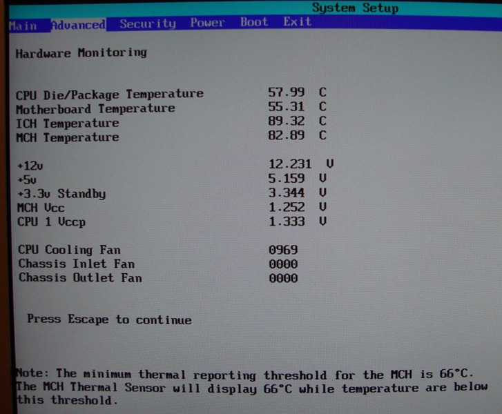

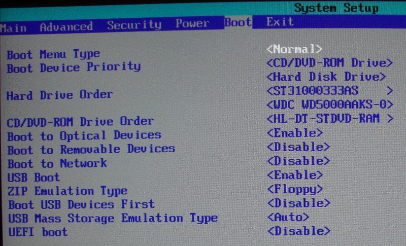

rcg Posted October 9, 2009 Author Share Posted October 9, 2009 Well, as I don't have my PATA DVD drive anymore, I won't be able to run some tests. I just verified that I could boot the iPC 10.5.6 install DVD from my SATA drive no matter how I configured my BIOS: Native/IDE, Native/AHCI and Legacy. I probably could not do this back when I installed iPC because of the SATA ports I used. As you can see in the pictures below, today my SATA HDs are connected to ports 0 and 1 and my SATA DVD drive to port 4. Here are my BIOS screenshots: Link to comment https://www.insanelymac.com/forum/topic/169167-ipc-successfully-installed-on-intel-dg33bu-and-xfx-geforce-8500-gt/#findComment-1293975 Share on other sites More sharing options...
sovin Posted October 13, 2009 Share Posted October 13, 2009 Hello, When I boot from PATA DVD drive the system freezes as like GPL_Happy said Error screen attached Link to comment https://www.insanelymac.com/forum/topic/169167-ipc-successfully-installed-on-intel-dg33bu-and-xfx-geforce-8500-gt/#findComment-1297046 Share on other sites More sharing options...

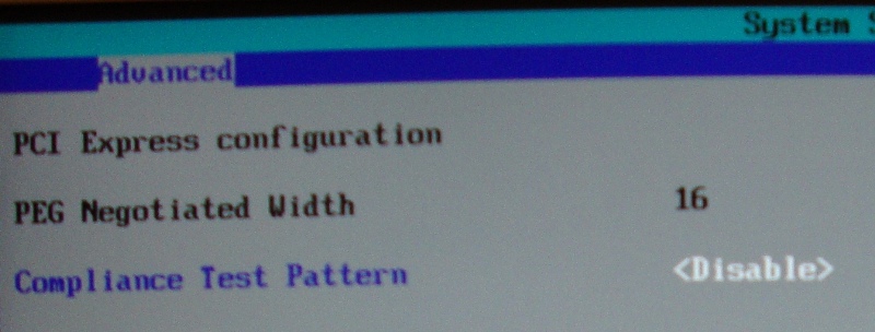

sovin Posted October 13, 2009 Share Posted October 13, 2009 At last I booted iPC distr I checked again BIOS setting and found that I missed one - Compliance Test Pattern it must be DISABLED Link to comment https://www.insanelymac.com/forum/topic/169167-ipc-successfully-installed-on-intel-dg33bu-and-xfx-geforce-8500-gt/#findComment-1297146 Share on other sites More sharing options...
