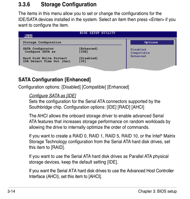

Beerkex'd Posted April 19, 2009 Share Posted April 19, 2009 Yes. Yes you do. Your P5Q motherboard has the P45 chipset which has the Intel ICH10 controller. The six red plugs on your motherboard are connected to it. Don't use the orange or the white plug. Link to comment https://www.insanelymac.com/forum/topic/162682-ideneb-v14-installation-problem/#findComment-1136557 Share on other sites More sharing options...
PowerMacG4 Posted April 19, 2009 Author Share Posted April 19, 2009 Ok, I look where it was plugged in, and looked in the BIOS, and I don't have the option to do that. Link to comment https://www.insanelymac.com/forum/topic/162682-ideneb-v14-installation-problem/#findComment-1136568 Share on other sites More sharing options...
Beerkex'd Posted April 19, 2009 Share Posted April 19, 2009 Alright. Whatever you say. I give up. This is a picture of a page in the manual for your motherboard. I'll leave you to draw your own conclusions. Link to comment https://www.insanelymac.com/forum/topic/162682-ideneb-v14-installation-problem/#findComment-1136579 Share on other sites More sharing options...
