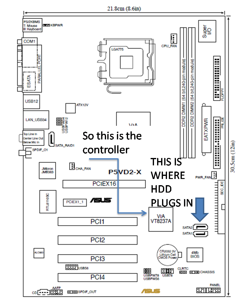

Beerkex'd Posted April 16, 2009 Share Posted April 16, 2009 No, your board has support for two PATA devices. Look at this picture from your manual. I assumed that your board has Intel chipset, I was wrong. If your harddrive is PATA, it will be connected to the VIA 8237A. The iPC 10.5.6 DVD has support for this chipset. The DVD you are using now probably doesn't. If your harddrive is SATA, connect it to the JMicron controller. Then it will work with your install DVD. Link to comment https://www.insanelymac.com/forum/topic/162281-will-leopard-install-on-this-machine-hdd-not-showing-uphelp/#findComment-1134474 Share on other sites More sharing options...

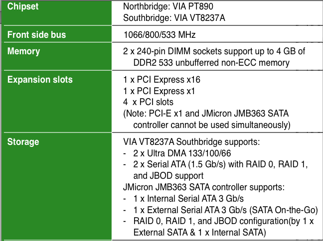

Beerkex'd Posted April 17, 2009 Share Posted April 17, 2009 As I said in post #8 Before I can tell you anything, you need to find out where your HDD is connected on the motherboard. After hours of exthausive research we can now safely say that it will be connected to either the VT8237 or the JMicron. In your motherboard manual you can find a drawing of the motherboard that will show you where the two controllers are and which plugs belongs to which controller. Look where the cable from the HDD goes. Link to comment https://www.insanelymac.com/forum/topic/162281-will-leopard-install-on-this-machine-hdd-not-showing-uphelp/#findComment-1135026 Share on other sites More sharing options...
what the....... Posted April 17, 2009 Author Share Posted April 17, 2009 ok i found it out the hdd controller thing is the VIA VT8237A.. ohh and its SATA ok now what? thanks Link to comment https://www.insanelymac.com/forum/topic/162281-will-leopard-install-on-this-machine-hdd-not-showing-uphelp/#findComment-1135032 Share on other sites More sharing options...
Beerkex'd Posted April 17, 2009 Share Posted April 17, 2009 Try setting the VIA controller to RAID mode, then boot from the install DVD and see if your HDD appears. RAID mode implies AHCI so that should work, if the controller doesn't mind booting up with only one HDD even if it's set to RAID mode. If that doesn't work here are some other options: Use a HDD connected to the JMicron controller. Use an install DVD that has drivers for the VT8237A, that are available during boot. I am 98% sure that the iPC 10.5.6 will work. Patch the DVD you are using now to include the driver that's missing from it. Don't ask me how because I don't know. The driver that needs to be present is VIAAppleATA.kext. Link to comment https://www.insanelymac.com/forum/topic/162281-will-leopard-install-on-this-machine-hdd-not-showing-uphelp/#findComment-1135036 Share on other sites More sharing options...
what the....... Posted April 17, 2009 Author Share Posted April 17, 2009 OMG THANK YOU SOOOO MUCH... ITS SUCCESSFULLY INSTALLING NOW JUST THAT CHANGE FROM IDE TO RAID FIXED IT THANK YOU THANK YOU THANK YOU U ARE AN ABSOLUTE LEGEND WITHOUT YOUR HELP I WOULD HAVE GIVEN UP THANKYOU BEERKEX'D THIS GUY IS A LEGEND Link to comment https://www.insanelymac.com/forum/topic/162281-will-leopard-install-on-this-machine-hdd-not-showing-uphelp/#findComment-1135049 Share on other sites More sharing options...
