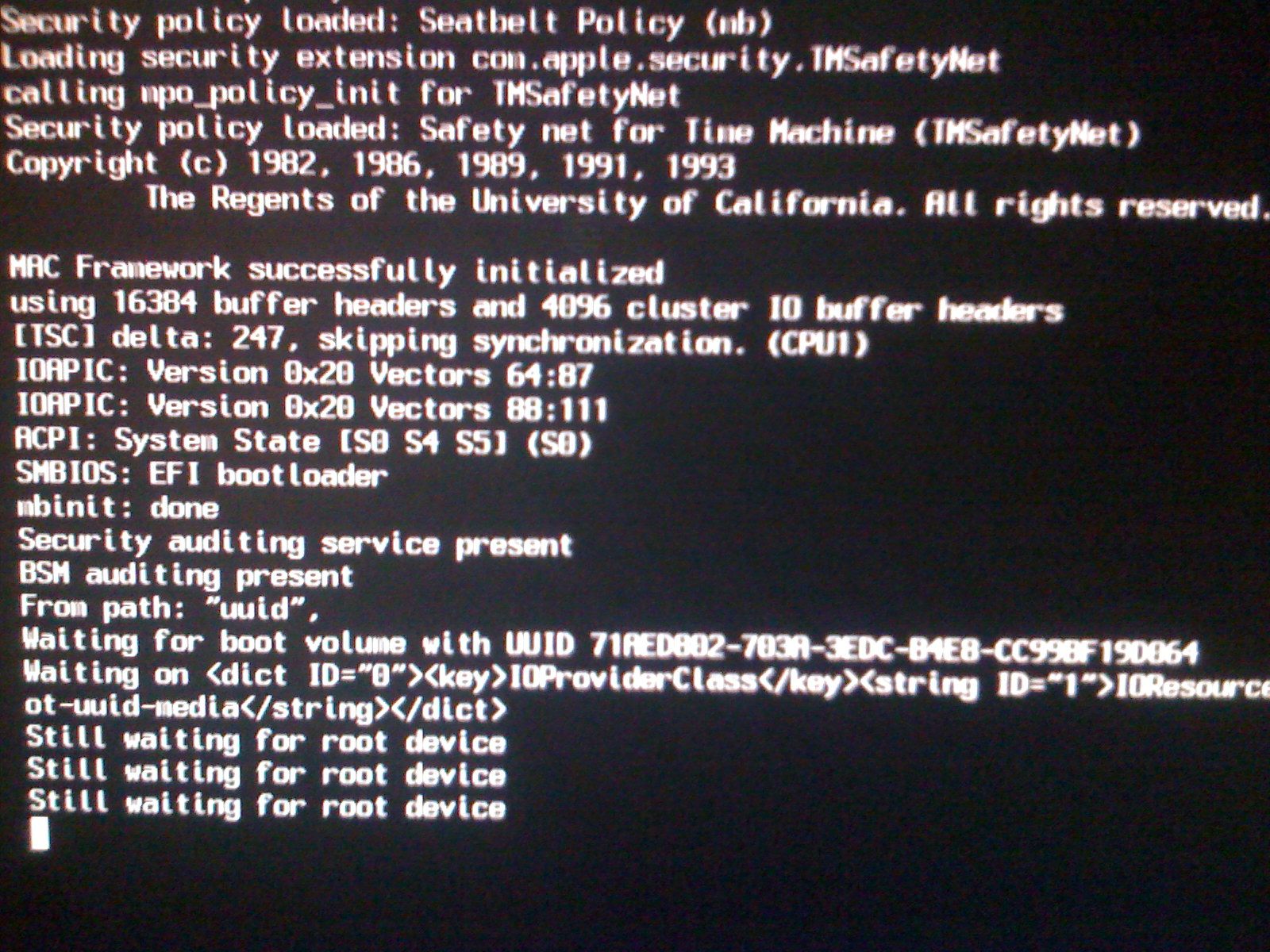

Still waiting for root device
This is generally one of three things:
1. If you are using PATA (The old IDE Ribbon Cable Drives) you will want to make sure that the drive you are installing to is set to MASTER via the jumpers and the actual drive itself. Id also recommend that you have the drive on the cable's first connector.
2. If you are using SATA drives try going into the BIOS and changing the SATA Mode from AHCI to IDE.
3. Chipset related. If your booting the install disk and are getting this issue and the first two do not fix the problem its probably chipset related. In the case of SATA, some motherboards have more than one SATA control and so one or the other may be compatible. You can check your user manual or online to see if this is the case and then plug into the appropriate connector.
I tried with ideneb...
kernel 9.5 voodo stuck at "still waiting for root device"
Orginal kernel? stuck at black screen when tried -f -v, when I made non of them I got apple logo with no animation.
I install only one kernel and and Polish language.

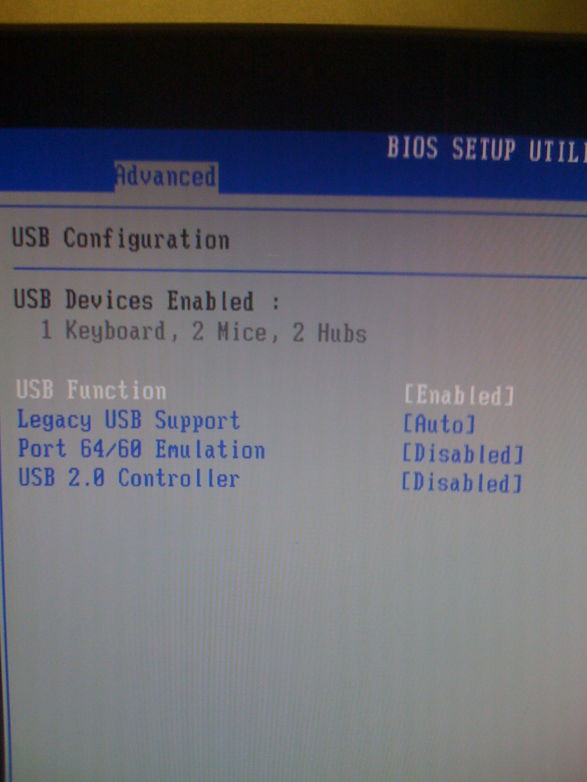

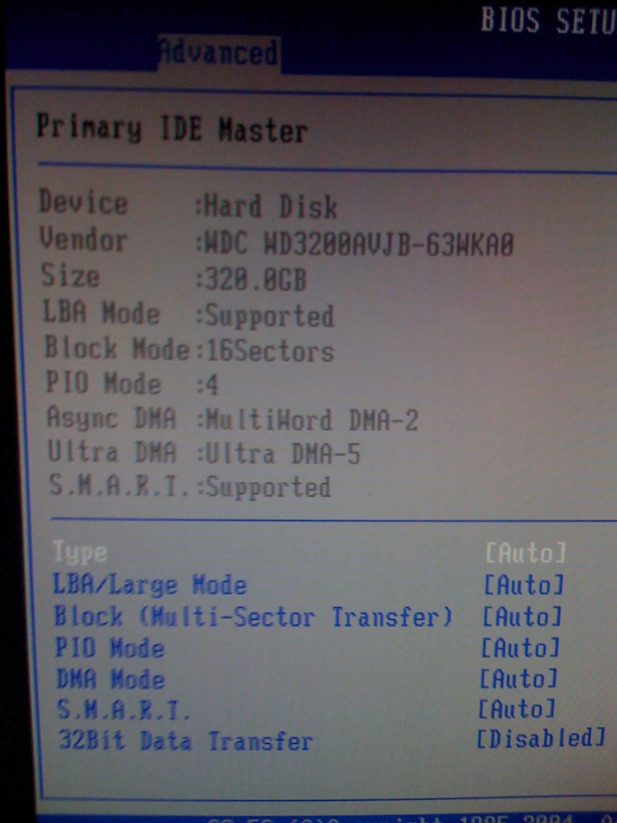

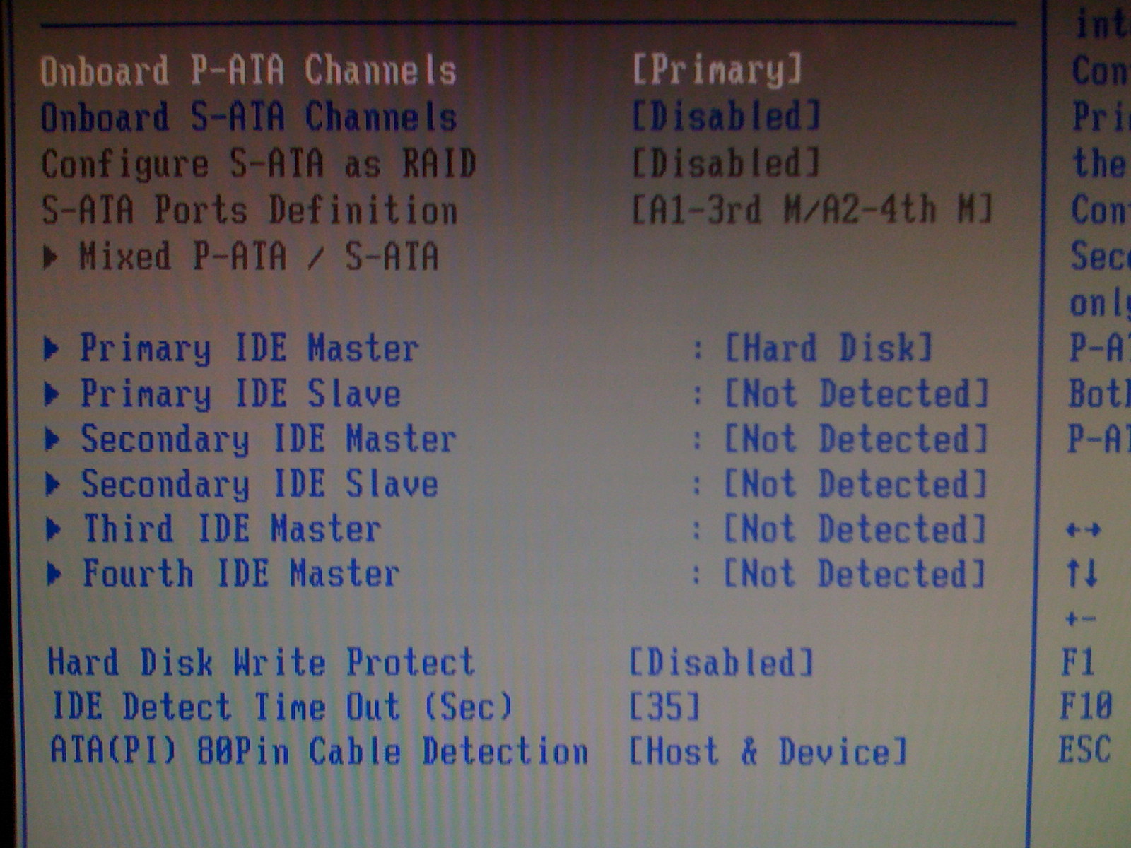

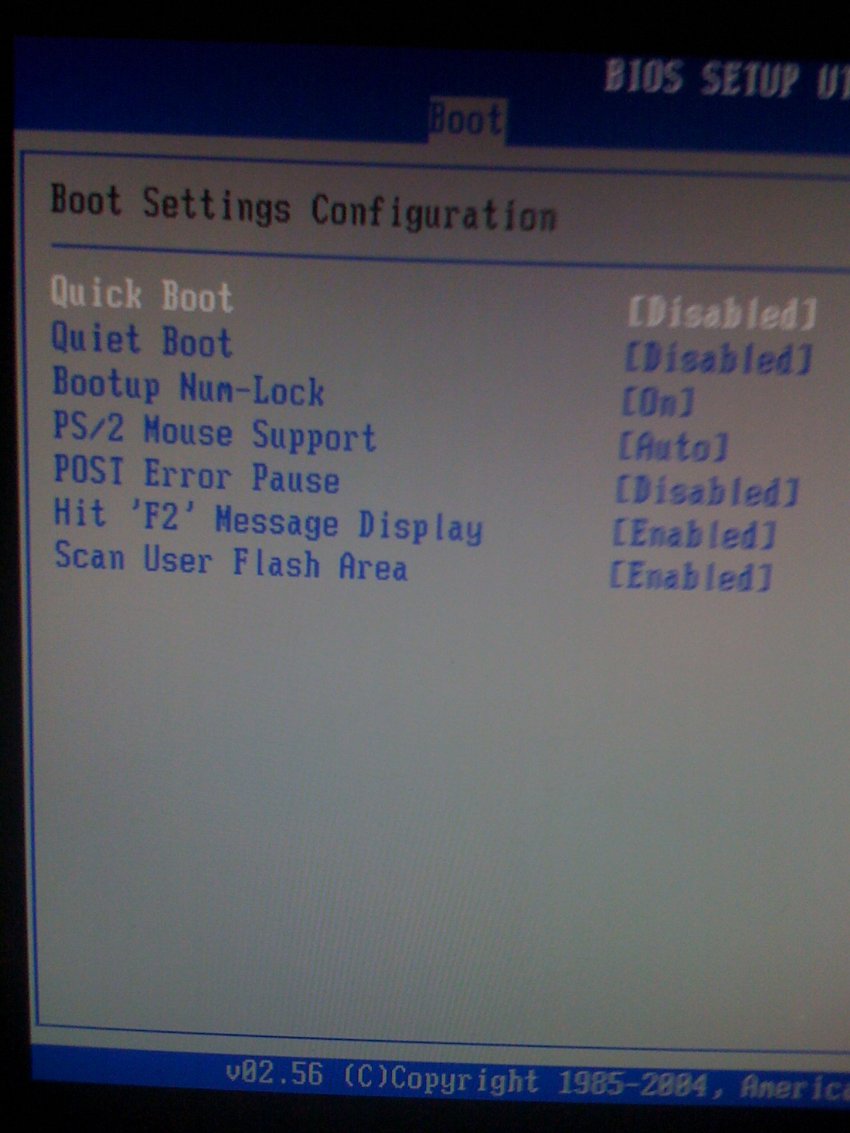

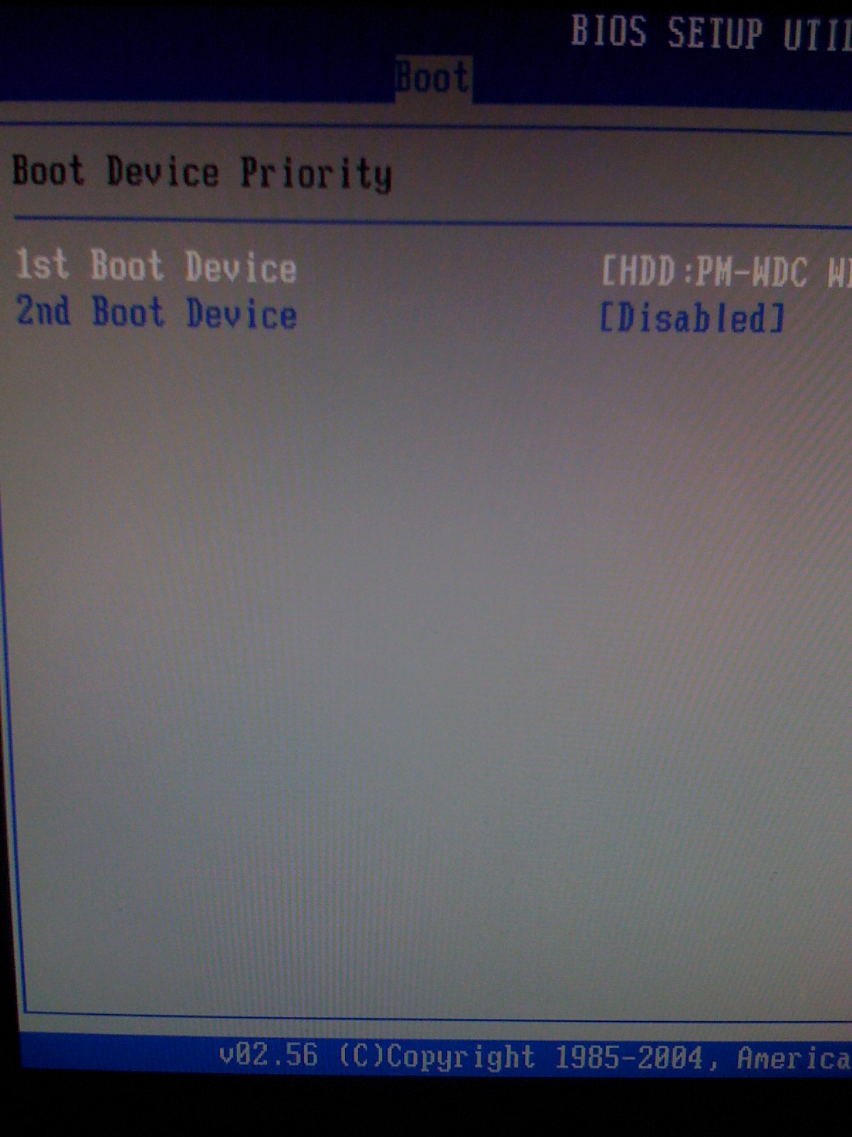

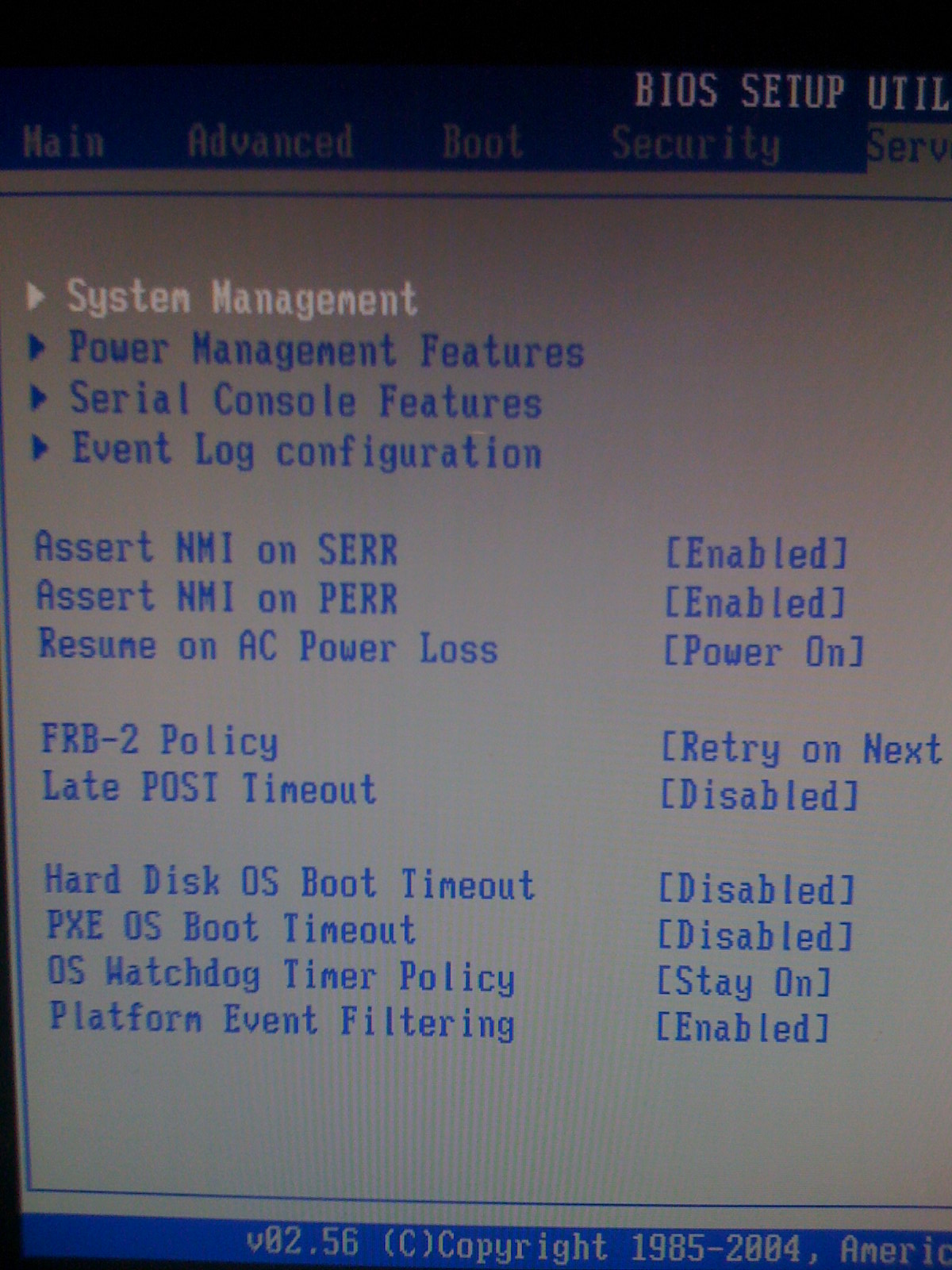

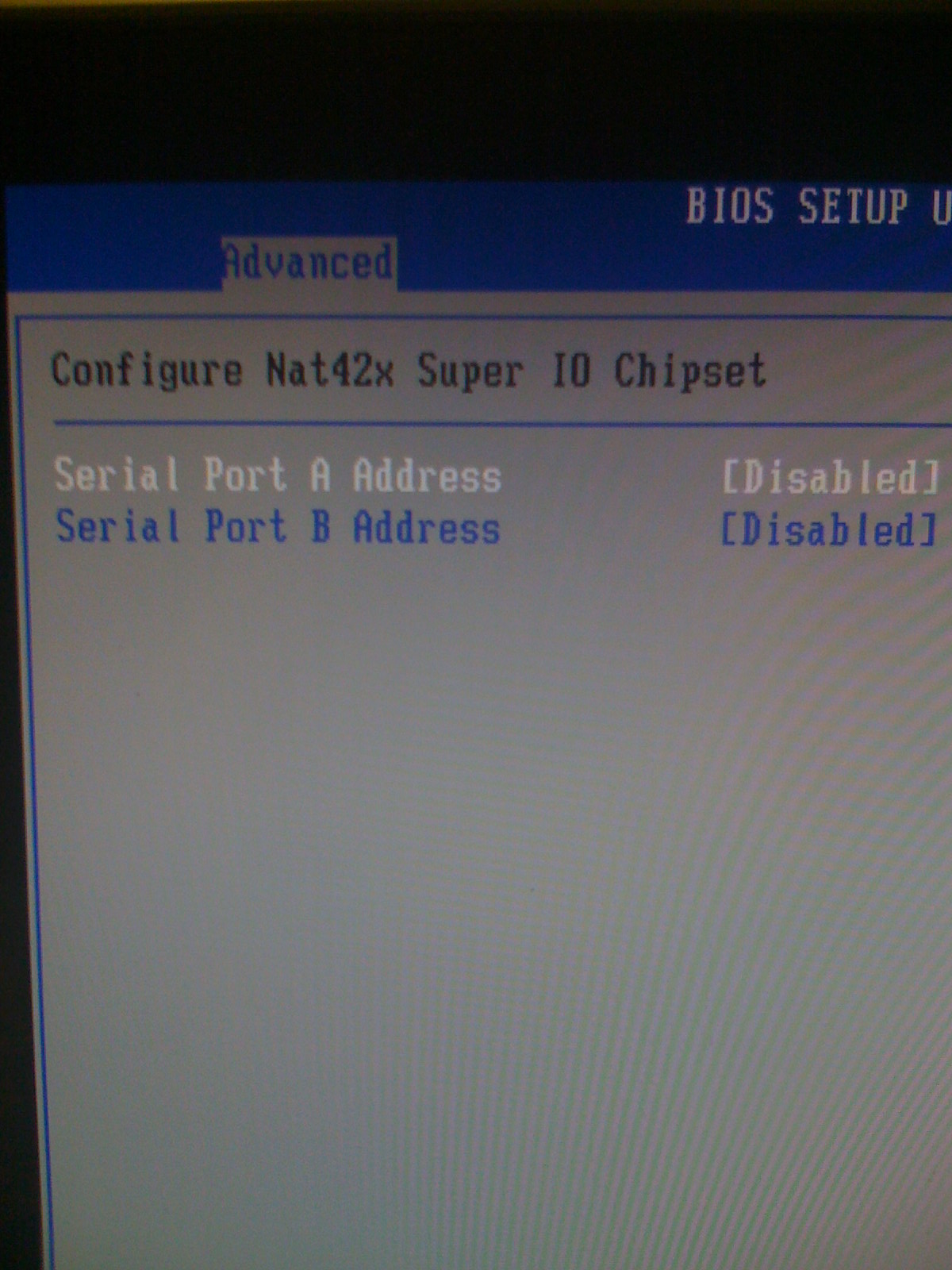

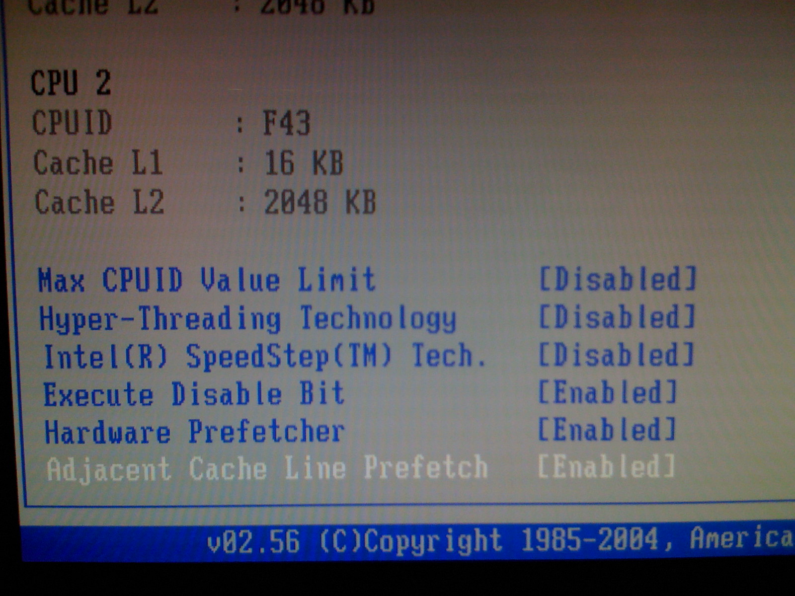

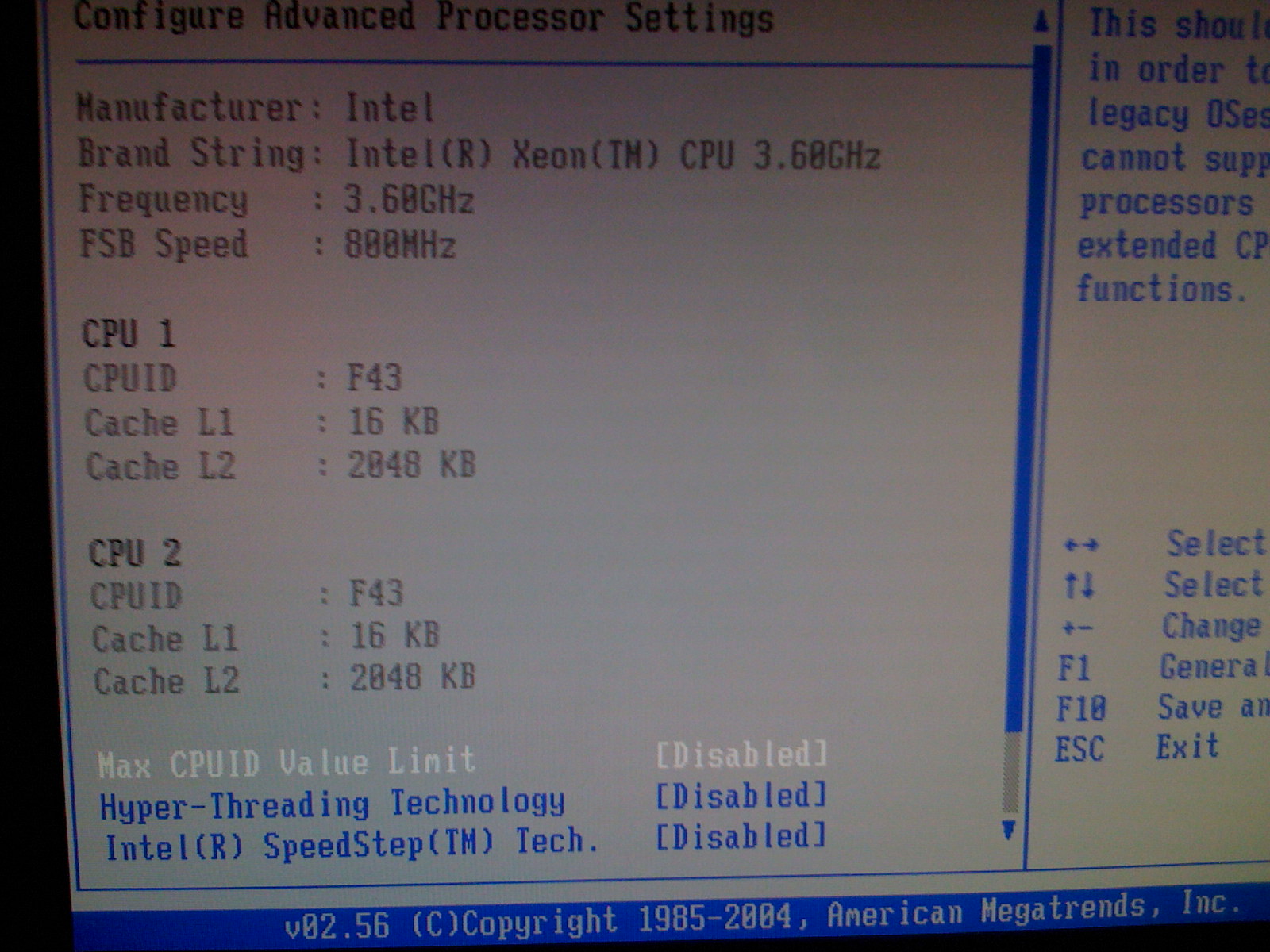

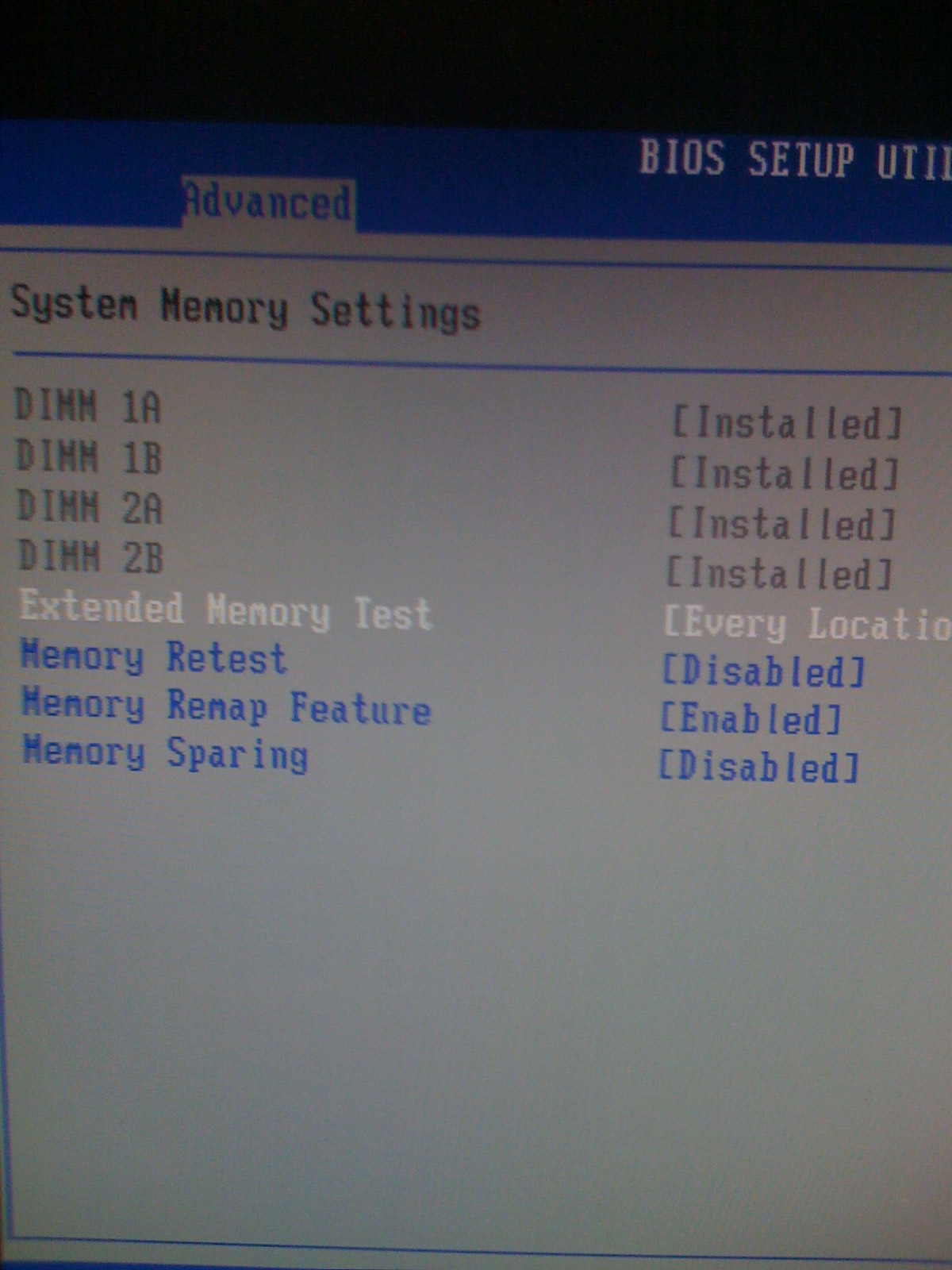

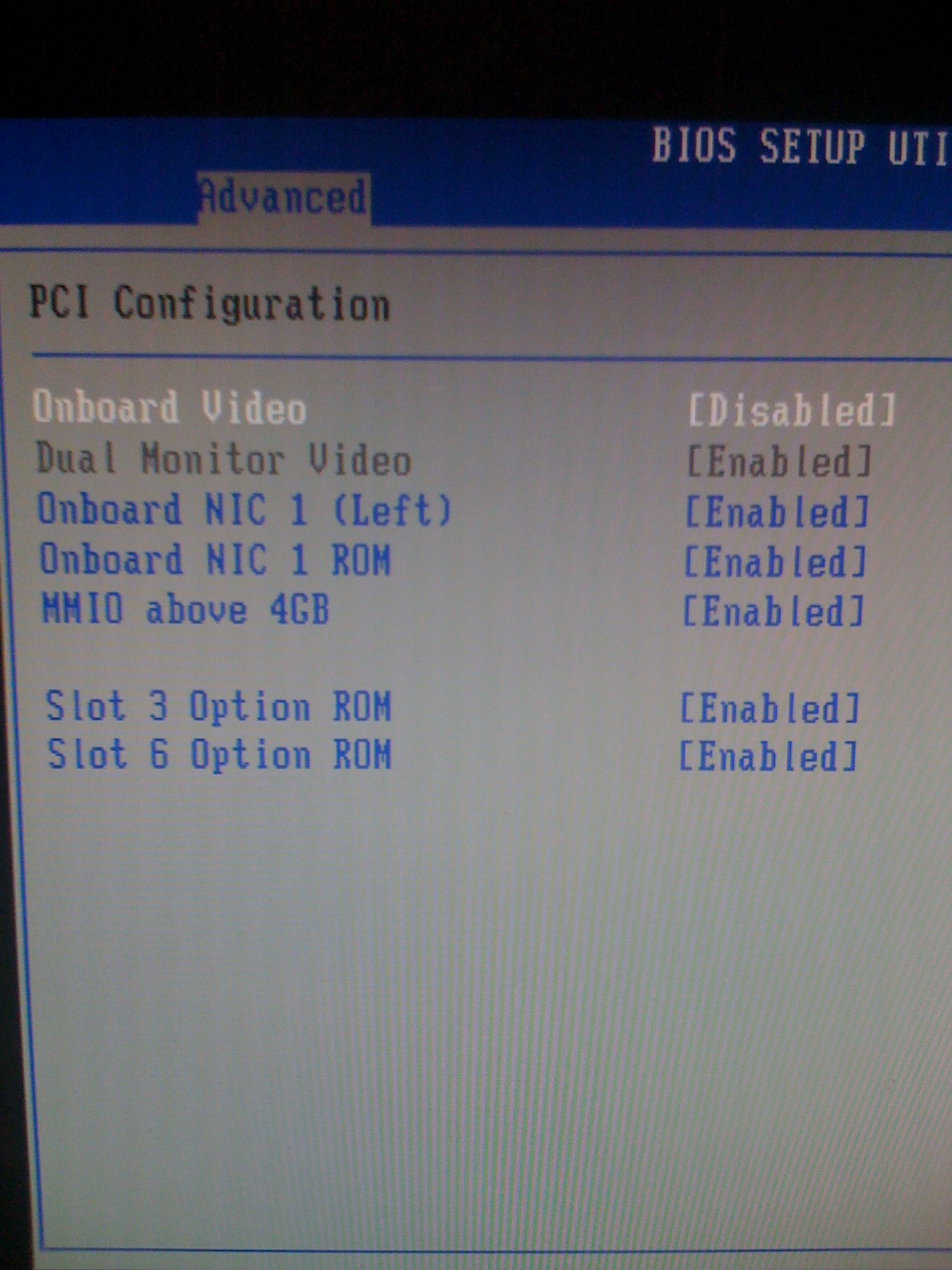

I give you screen from boot, and my bios config.
As you can see everything was allright and still non 10.5.6. distro workd.
