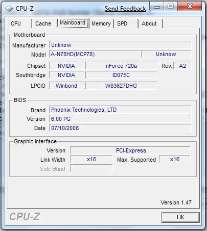

Attached is a screenshot from CPUZ of my motherboard. I hope I posted this in the right section!
