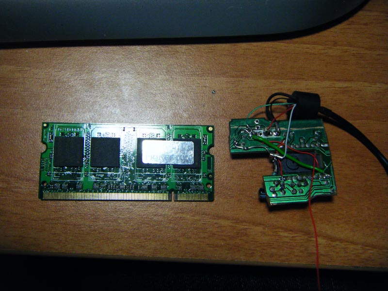

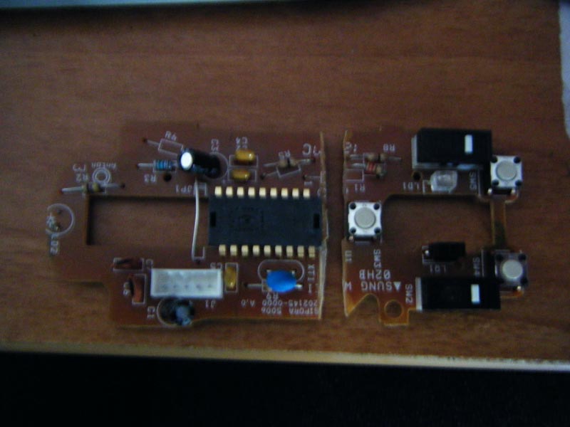

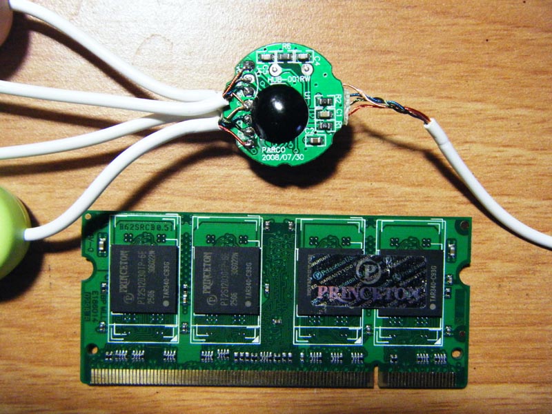

Basically ive taken a standard logitech usb mouse, hacked it down to its very bare esstenitals, inserted inside the case along with a usb hub

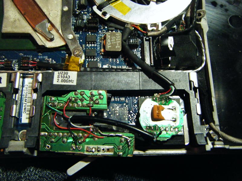

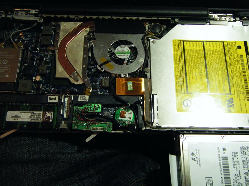

Ive tapped into the usb connection between the motherboard and bluetooth module, attached the hub and rerouted the cable for the bluetooth module to the hub.
Ive placed a small piece of metal (which is attached and insulated on the L-bracket) underneath the right mouse button to make the contact.
All the boards are located in a spare ram module slot, ive already got the maximum amount of ram on one stick so i didnt need it anyway.
