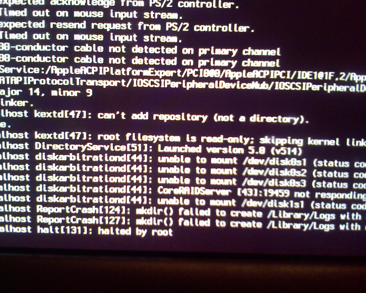

aLinux09 Posted March 17, 2009 Author Share Posted March 17, 2009 now i cant even boot from the dvd i had some errors on my partitions because of the reset and force shut down i fixed them with a partition manager by formating the one with errors when i insert the dvd i press enter and it starts loading from dvd and after 1 minute it shut downs i tried to boot in -v and i noticed some errors and after a short time "system halted by root" here is a picture Link to comment https://www.insanelymac.com/forum/topic/157929-urgent-help-with-iakatos/#findComment-1109415 Share on other sites More sharing options...

Beerkex'd Posted March 18, 2009 Share Posted March 18, 2009 I'm curious about the "80-conductor cable" messages - those are the IDE cables connecting your P-ATA devices to your motherboard. Check that these cables are firmly plugged in to the drives and the motherboard. If the connections are fine and you are using antique DMA-33 style IDE cables, you should really get some 80-conductor cables instead. 80-conductor cables have better RF noise isolation and allow for faster data transfer speeds. It's fine that you got your keyboard working but you will have problems when using PS2 keyboard and USB mouse at the same time. You need to use either one or the other. I would buy a USB keyboard. Link to comment https://www.insanelymac.com/forum/topic/157929-urgent-help-with-iakatos/#findComment-1110040 Share on other sites More sharing options...
