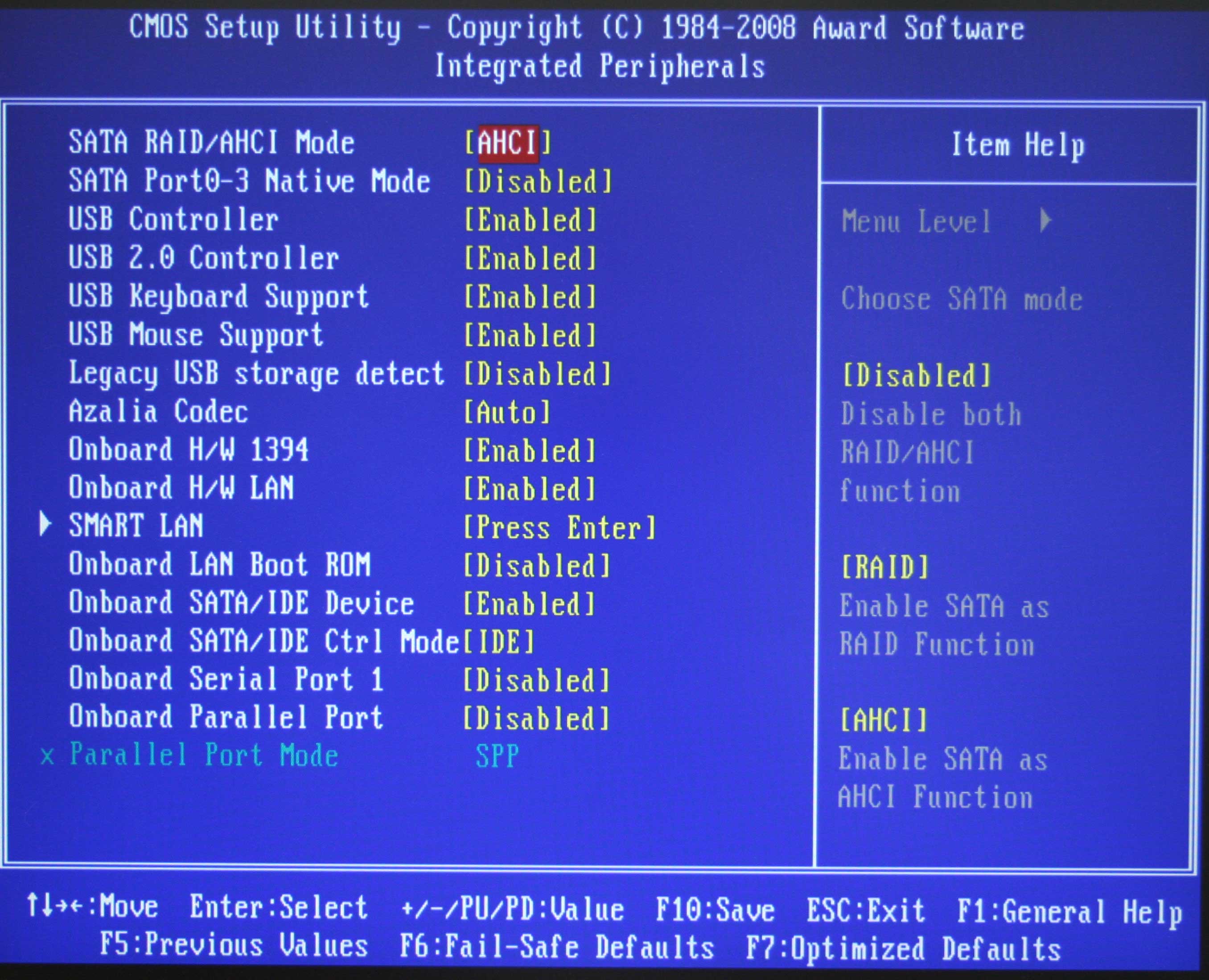

SpokeDigital Posted April 20, 2009 Author Share Posted April 20, 2009 Potential Solution found: It appears that I have found a fix. The following seems to be working for me: 1) Extracted extracted latest iPC 10.5.6 Universal iso with Pacifist 2) Installed JMicronATA.kext with Kext Helper b7 (included with Kalyway 10.5.2 DVD) 3) Cross fingers and Reboot 3) Set JMicron controller to IDE mode in BIOS (pic attached) a) FYI: AHCI mode resulted in GSOD on boot. Solution Testing: Previous crashes occured with sustained use of my IDE drive connected to the JMicron controller. In particular I was getting consistent panic when using Transmission to download files to this drive. Panic would occur within minutes of Transmission activity. To test fix I did the following: 1) Ran Transmission saving data to the IDE drive -- no panic after 2 hours of steady use 2) Large file transfer between IDE and SATA drive. No panic after 3 copies of 2+GB file Though my tests were not terribly conclusive, I am pretty certian this has fixed my issue. I will follow up with any futher panics. My set-up: Kalyway 10.5.2 Bios F13 6GB Ram - 2x1GB, 2X2GB Main HD: WD 500GB SATA drive on ICH9 Sata port (also SATA DVD drive & Seagate 250GB drive on ICH9 ports) Storage Drive: WD 500GB IDE (PATA) on JMicron IDE port Additional system specs in my sig. Special thanks to Beerkex'd for his help in pointing me in the right direction. Link to comment https://www.insanelymac.com/forum/topic/157634-solved-gsod-after-upgrading-ram-to-6gb-jmicron-controller-issue/#findComment-1137849 Share on other sites More sharing options...
