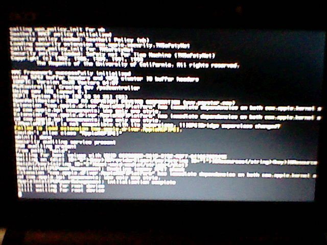

for anyone having problems with: Failed to load extension com.apple.driver.AppleACPIPCI
in my case it was a problem with IOPCMCIAFamily.kext, so You could do like following:
1. boot from your installation DVD (i'm using iDeneb 1.6 10.5.8 lite) and hit F8 at the beginning to get boot options prompt
2. type -s to start in single user mode
3. after # prompt shows, type:
mount -uw /
(dvd won't be writeable anyways ;p)
4. then type:
mkdir /Volumes/HDD
5. after that type:
mount -t hfs /disk/disk0s1 /Volumes/HDD
note that disk0s1 is in my case first partition of my main hdd in my compal fl90 laptop, you can get to know which partition you are using by typing in:
ls /dev/disk*
and then checking one by one with:
fstyp /dev/disk{the disk number you got from previous command}
the one that returns "hfs" is probably the one your hackosx resides in :-P
6. after mounting Your partition do the following:
cd /Volumes/HDD
rm -rf System/Library/Extensions/IOPCMCIAFamily.kext
kextcache -k System/Library/Extensions
reboot
(you will probably need to reboot manually by pressing your reset/power button)
now your system should boot without problems but the wifi probably wont work (in my case it doesn't)
