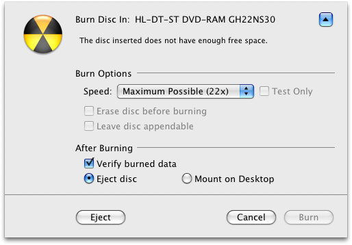

amir 20 Posted February 21, 2009 Share Posted February 21, 2009 Has anybody ever ran in to a problem with burning ISO images? I have a HL-DT-ST DVD-RAM GH22NS30 DVD burner with Kalyway Mac OS X 10.5.2. This is the error I get for all DVD's inserted: The disc inserted does not have enough free space. Edit: So I tried Toast instead of Disk Utils and it worked. Weird.... Link to comment https://www.insanelymac.com/forum/topic/154291-getting-error-when-trying-to-burn-dvd-isos/ Share on other sites More sharing options...
Khan_Man Posted May 13, 2009 Share Posted May 13, 2009 I just ran into the same problem. I've tried this same burner in 10.5.6, 10.5.3, 10.5.2 and 10.4.9 also on 945 and p45 chipsets. all with the same error. Damn! I just bought 3 of these drives! Toast works for burning DVD images and I can burn CDs off the desktop, just can't burn data DVDs from desktop or ISOs from disk tools. I've also tried updating to 1.0.2 firmware, no change. Khan Link to comment https://www.insanelymac.com/forum/topic/154291-getting-error-when-trying-to-burn-dvd-isos/#findComment-1155544 Share on other sites More sharing options...
Armacham Posted May 20, 2009 Share Posted May 20, 2009 Same problem with HL-DT-ST DVD-RAM GH22LS30 (tested on ICH10R & jMicron). edit: Toast 10 is the only one that works. Link to comment https://www.insanelymac.com/forum/topic/154291-getting-error-when-trying-to-burn-dvd-isos/#findComment-1160915 Share on other sites More sharing options...
