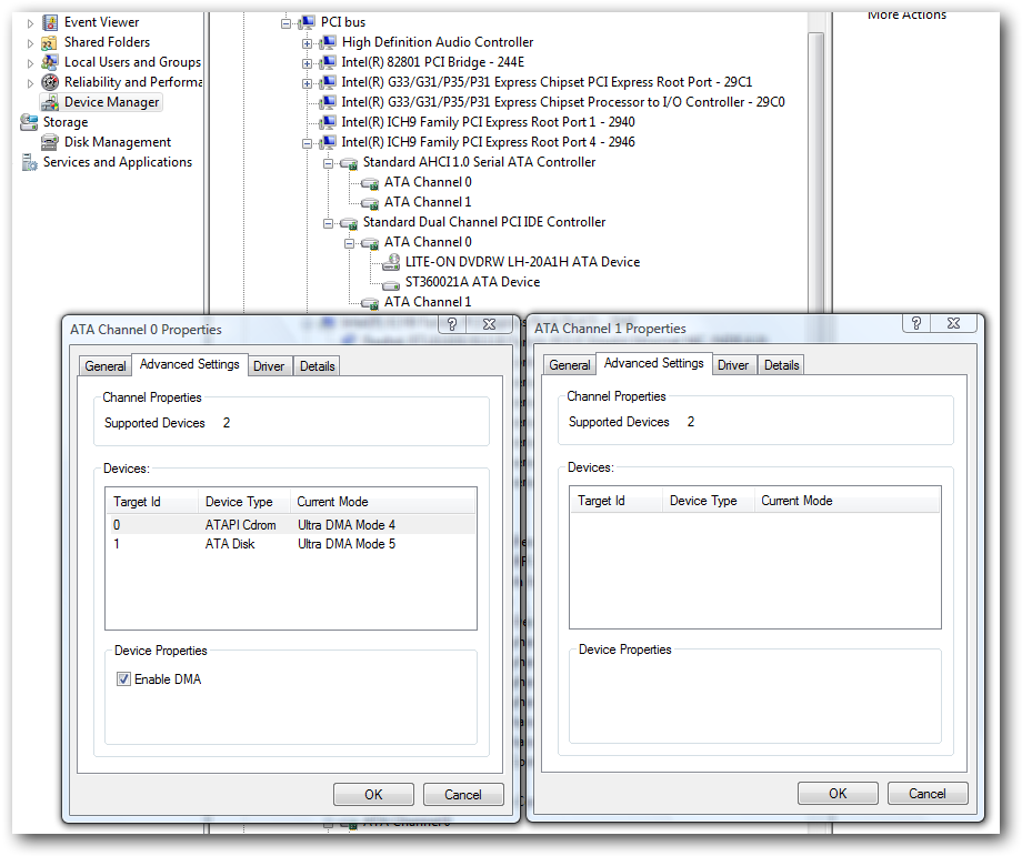

thorazine74 Posted February 17, 2009 Share Posted February 17, 2009 What OS X version are you running? This is IOATAFamily v2.0.0 from 10.5.6: IOATAFamily.kext.v2.0.0.Vanilla.10.5.6.zip It has both your SATA & PATA controllers device ids, it seems some real Mac have exactly the same hardware as yours. What BIOS options do you have? Does it happen the same way in AHCI mode? It should have no effect but you could try just in case... How does the drive show up in Windows Device Manager? It seems the secondary channel is malfunctioning, disabled or not working according to OS X so if the drive is connected to that one chances are it wont be detected. I'm not sure if you can in a laptop but changing drive setup (secondary to primary) could help. Link to comment https://www.insanelymac.com/forum/topic/153009-problem-with-my-dvd-drive-on-a-ich8m/#findComment-1083329 Share on other sites More sharing options...
Jokerchris Posted February 17, 2009 Author Share Posted February 17, 2009 Im on 10.5.6 So thats the right kext. Let me try it. I dont know exactly the bios options but i will look at the next reboot. how can i determine in windows xp whether it is primary or the secondary port? Link to comment https://www.insanelymac.com/forum/topic/153009-problem-with-my-dvd-drive-on-a-ich8m/#findComment-1083338 Share on other sites More sharing options...

thorazine74 Posted February 17, 2009 Share Posted February 17, 2009 img{-moz-force-broken-image-icon:1;} Both kexts are mostly the same so its no surprise it doesnt work either. You can check in Windows in the device manager, show select devices by connection and show the properties of each Primary and Secondary IDE channel hanging from the IDE controller (I'll post a screenshot when I reboot into Windows). Also some BIOS list all the connected IDE devices ordered by channels, look there if the DVD drive show up as Primary Master or Secondary Master. I'm guessing that option in your BIOS just enables or disables the channels but I dont know why making them both enable makes your drive disappear, disabling the channels should not have an effect if there is no device. Do you have some SATA option labeled like SATA Legacy/Native Mode or similar? EDIT: here is the screenshot in Vista, XP has a different layout but its the same. You should be able to see it in the BIOS anyway... Link to comment https://www.insanelymac.com/forum/topic/153009-problem-with-my-dvd-drive-on-a-ich8m/#findComment-1083653 Share on other sites More sharing options...
