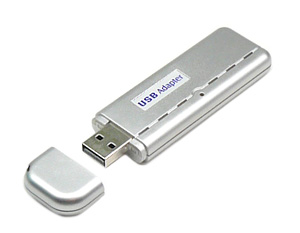

chimmu Posted February 9, 2009 Share Posted February 9, 2009 I got a RTL8187 based USB Wireless LAN adapter working on my AAO running Leopard 10.5.5 ! I had purchased a USB Wireless lan adapter from Meritline for $10 http://www.meritline.com/ieee-802-11g-wire...-pen-drive.html Used the drivers from from the Realtek website 8187L driver did not work the first time but after a restart, tried ifconfig en1 up/down a couple of times and got it to work! its not an elegant solution for this small netbook but is working! Link to comment https://www.insanelymac.com/forum/topic/152108-acer-aspire-one-usb-wlan-adapter-working-rtl8187-leopard-1055/ Share on other sites More sharing options...
