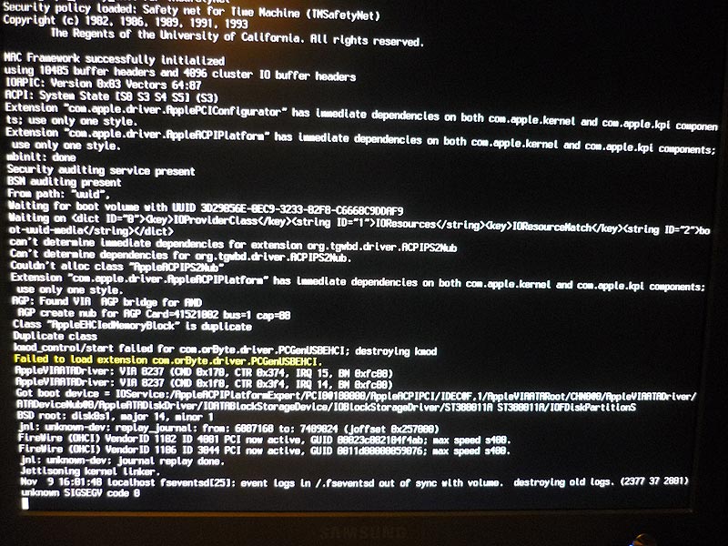

ddcarnage Posted November 10, 2008 Share Posted November 10, 2008 Hi all, I'm trying to get iDeneb 1.3 1.5.5 working on an Asus A8V Deluxe. Full specs are here : http://www.asus.com/products.aspx?modelmen...;l3=68&l4=0 I have an Athlon 64 X2, an ATI 9600Pro AGP and I'm using an IDE hdd. I've unplugged all my other hard drives to make sure nothing interferces. I also have a Creative Audigy soundcard. I've beeing searching a lot on the web and fixed a couple of problems. The furthest I've gotten is by using the Kernel 9.4.0 StageXNU with the AMD patch and VIA-SB chipset. I also had the Extension "com.apple.driver.AppleIntelCPUPowerManagement" has immediate dependencies on both com.apple.kernel and com.apple.kpicomponents error that I fixed by going in the terminal and doing rm -rf /Volumes/YourOSXDrive/System/Library/Extensions/AppleIntelCPUPowerManagement.kext Also seems I have to do cpus=1 because I have an Asus board. So, now by booting with "cpus=1 -x -v", I'm getting an error and I've attached a picture of my monitor and I'm not quite sure what to try now... Any help greatly apreciated. Thanks Frank Link to comment https://www.insanelymac.com/forum/topic/135611-ideneb-13-1055-on-asus-a8v-deluxe-and-athlon-62-x2-problems-booting/ Share on other sites More sharing options...
