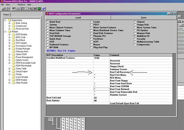

diablonet Posted November 13, 2008 Share Posted November 13, 2008 Hello, I killed my DV8000t (intel based) motherboard, trying to do the Phoenix bios editor trick, but i did it before reading that it does not work with the phoenix editor, so, you managed to edit the firmware, wich method did you used to compile / compress the bios again?, I am asking cause I found this.... Sameh El-Gohary Nov 4, 2008 04:23:58 GMT Unassigned -------------------------------------------------------------------------------- ATTENTION EVERYONE PLEASE. Read Carefully, This is how things are really are. 1.Every phoenix bios supports tons of features that are either turned on/off depending on its version, oem requirements, model..etc. 2.There is a feature called "Bios Fail Recovery" in other words, the ability of the bios to be recovered using the phoenix recovery tool. 3.Certain Bios versions got this feature turned off. You'll never be able to recover ur bios. 4.How can we know? So simple, decompile the .wph bios image with Phoenix bios editor v.2.201 5.Under a tab called "Multiboot III" u may see (*) besides the string "Bios Fail Recovery" which means you are lucky. If it's absent, donâ€t bother urself trying. 6.I'm wondering why HP ships some of its notebooks with such feature turned off? It's there by default, so they ask Phoenix to deactivate it! I'm disappointed. 7.To prove what I've wrote, attached is a screenshot for a decompiled bios with such feature turned off _________________________ I recommend volunteering for testing every bios version on hp website. This way we can make a list of "lucky notebooks". As a start, I've tested all the Pavilion dv5000. unfortunately the donâ€t support bios recovery. Thanks for reading. I hope everything is clear now. Can you compile a version of your bios with the * BIOS FAIL recovery enabled, maybe that way I can recover my motherboard without desolder the chip, any suggestion? Link to comment Share on other sites More sharing options...
redratfish Posted November 13, 2008 Author Share Posted November 13, 2008 yes the Phoenix bios for dv8000 has no recovery. the only way to fix it is by taking out the tsop bios chip then reprogram with a willem programmer. software to apply edit bios module back to the compress bios code is called phnxmod.exe phoenix editor will not compress your bios correctly. to compile the bios with the boot block recovery would take a loot of work. not really worth it. once you flash the bios from dos . with this hacked bios . you dont have to worry about bricking . also if you put the bios.wph file that you compile with phoenix in a hex editor and compare with the original . you will see that the compile version looks different the. even if you get a version with recovery enable it still wont work with the crisis recovery. your best bet would to order a preflash stt 39vf080 chip from this guy in the uk http://bios-repair.co.uk/ use a hot air paint stripper gun. to remove the old chip and solder the new one in. cheapest way out. Link to comment Share on other sites More sharing options...
