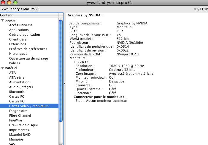

leo3949 Posted October 31, 2008 Author Share Posted October 31, 2008 enfait je crois que ma carte marche il y a l'acceleration materiel mais sa me dit carte nvidia inconnu Link to comment https://www.insanelymac.com/forum/topic/134008-ge-force-9800-gt-512mo-oc/#findComment-950571 Share on other sites More sharing options...

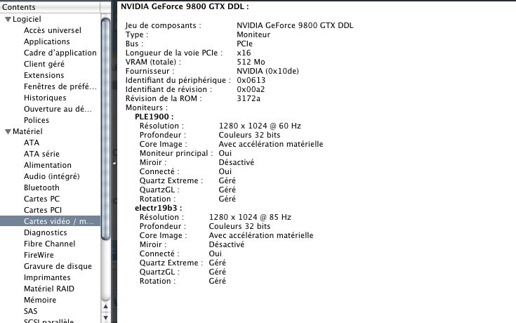

alexcooltranquille Posted November 1, 2008 Share Posted November 1, 2008 Petite contribution Link to comment https://www.insanelymac.com/forum/topic/134008-ge-force-9800-gt-512mo-oc/#findComment-951357 Share on other sites More sharing options...
PM! Posted November 1, 2008 Share Posted November 1, 2008 Petite contribution Trop tard Par contre, ce Nvidia9000SeriesDriver_v2@mediafire ça ça peut être utile Link to comment https://www.insanelymac.com/forum/topic/134008-ge-force-9800-gt-512mo-oc/#findComment-951426 Share on other sites More sharing options...
leo3949 Posted November 1, 2008 Author Share Posted November 1, 2008 sa change rien ma carte est toujours pas reconnu Link to comment https://www.insanelymac.com/forum/topic/134008-ge-force-9800-gt-512mo-oc/#findComment-951765 Share on other sites More sharing options...
alexcooltranquille Posted November 1, 2008 Share Posted November 1, 2008 Bun si elle est full reconnue ta carte graphique (QE / CI + résolution), c'est bien marqué pourtant. Link to comment https://www.insanelymac.com/forum/topic/134008-ge-force-9800-gt-512mo-oc/#findComment-951784 Share on other sites More sharing options...
leo3949 Posted November 1, 2008 Author Share Posted November 1, 2008 oui mais le truc qui me turlupine c'est que y pas le non de ma carte de plus elle est en pcie x8 or que mon ancienne carte marquait x16 Link to comment https://www.insanelymac.com/forum/topic/134008-ge-force-9800-gt-512mo-oc/#findComment-951791 Share on other sites More sharing options...
alexcooltranquille Posted November 1, 2008 Share Posted November 1, 2008 Arf c'est trois fois rien c'est cosmétique, si tu veux y remédier faut bidouiller le kext Link to comment https://www.insanelymac.com/forum/topic/134008-ge-force-9800-gt-512mo-oc/#findComment-951801 Share on other sites More sharing options...
leo3949 Posted November 1, 2008 Author Share Posted November 1, 2008 ah ok sinon sinon comment on modifie le kext sinon sa vas jouer sur le vitesse d'un jeu ou je peut laisser sa comme ca? Link to comment https://www.insanelymac.com/forum/topic/134008-ge-force-9800-gt-512mo-oc/#findComment-951811 Share on other sites More sharing options...
alexcooltranquille Posted November 1, 2008 Share Posted November 1, 2008 Ca changera rien du tout à part que tu feras chier pour vraiment pas grand chose. Sinon si tu veux vraiment que ça fasse beau: nvinject.kext > contents > info.plist > remplace "Graphics by nvidia" par "GTX 280" si tu veux avoir l'aire d'une GTX280 Et après une petite réparation d'autorisations. Link to comment https://www.insanelymac.com/forum/topic/134008-ge-force-9800-gt-512mo-oc/#findComment-951820 Share on other sites More sharing options...
leo3949 Posted November 1, 2008 Author Share Posted November 1, 2008 a ba ca ira je vais laisser comme ca merci pour les tuyau alex le mec cool et tranquile! Link to comment https://www.insanelymac.com/forum/topic/134008-ge-force-9800-gt-512mo-oc/#findComment-951822 Share on other sites More sharing options...
leo3949 Posted November 3, 2008 Author Share Posted November 3, 2008 enfait j ai trouvé pourquoi sa marquai x8 c parce que ma carte etait branché sur le sslot pcie x8 la je lai remit sur le slot x pciex16 et magique sa me remet x16! voila c'etait la nouvelle de la nuit! Link to comment https://www.insanelymac.com/forum/topic/134008-ge-force-9800-gt-512mo-oc/#findComment-953307 Share on other sites More sharing options...
