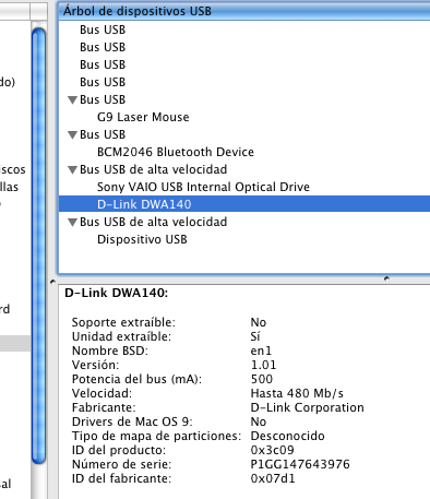

turtle8 Posted October 26, 2008 Share Posted October 26, 2008 Has anybody here successfully used the above wireless adapter? I've downloaded the Mac driver but my Hackintosh does not see that it is plugged into my USB port. The USB ports are recognized; my thumb drives do work. Link to comment https://www.insanelymac.com/forum/topic/133194-d-link-dwa-140-wireless-adapter/ Share on other sites More sharing options...
Kibitz Posted October 27, 2008 Share Posted October 27, 2008 In Terminal: sudo kextload /System/Library/Extensions/R*2870*.kext Unplug the Adapter. Plug it in and it does run. Link to comment https://www.insanelymac.com/forum/topic/133194-d-link-dwa-140-wireless-adapter/#findComment-945874 Share on other sites More sharing options...

turtle8 Posted October 28, 2008 Author Share Posted October 28, 2008 In Terminal: sudo kextload /System/Library/Extensions/R*2870*.kext Unplug the Adapter. Plug it in and it does run. Hey, it works! Thanks Kibitz Link to comment https://www.insanelymac.com/forum/topic/133194-d-link-dwa-140-wireless-adapter/#findComment-946331 Share on other sites More sharing options...
