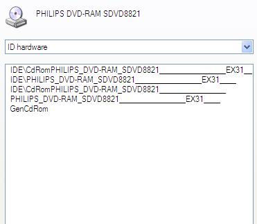

macita Posted November 12, 2008 Author Share Posted November 12, 2008 Hi slash.... NO I STILL CANNOT USE IT!!! GRRRR!!!!! Uhmm i think is an IDE device... IM really confused.... Here is the dump.txt that u already askd to me one month ago http://www.mediafire.com/download.php?gjvmkmwmjmi and in attach...you can see the ids from win xp... id.bmp Link to comment https://www.insanelymac.com/forum/topic/132320-acer-travelmate-no-ide-dvd-working/#findComment-963134 Share on other sites More sharing options...
slashack Posted November 12, 2008 Share Posted November 12, 2008 Hi slash.... NO I STILL CANNOT USE IT!!! GRRRR!!!!! Uhmm i think is an IDE device... IM really confused.... Here is the dump.txt that u already askd to me one month ago http://www.mediafire.com/download.php?gjvmkmwmjmi and in attach...you can see the ids from win xp... it seems u use AppleIntelPIIXATA.kext +-o SECD@1 <class IntelPIIXATAChannel, registered, matched, acti$ | | | | { | | | | "Channel Mode" = 1 | | | | "IOInterruptSpecifiers" = (<0f00000000000000>) | | | | "acpi-device" = "IOACPIPlatformDevice is not serializable" | | | | "IOInterruptControllers" = ("io-apic-0") | | | | "acpi-path" = "IOACPIPlane:/_SB/PCI0@0/SATA@1f0002/SECD@1" | | | | "Channel Number" = 1 | | | | "Command Block Address" = 368 | | | | "Control Block Address" = 884 | | | | "Interrupt Vector" = 15 | | | | } | | | | | | | +-o IntelPIIXPATA <class IntelPIIXPATA, registered, matched, a$ | | | { | | | "IOProbeScore" = 800 | | | "IOProviderClass" = "IntelPIIXATAChannel" | | | "Serial ATA" = No | | | "CFBundleIdentifier" = "com.apple.driver.IntelPIIXATA" | | | "Physical Interconnect" = "ATA" | | | "IOMatchCategory" = "IODefaultMatchCategory" | | | "IOPowerManagement" = {"CurrentPowerState"=2} | | | "IOClass" = "IntelPIIXPATA" | | | } | | | I think this portion of the dump indicates that the kext is beeing loaded, but your dvd is not detected. I'm guessing that from the fact that in the other channel u have a FUJITSU MHW2160BH which should be your hdd. Sorry, but i cant help u. Try looking different versions of AppleIntelPIIXATA Link to comment https://www.insanelymac.com/forum/topic/132320-acer-travelmate-no-ide-dvd-working/#findComment-963567 Share on other sites More sharing options...
