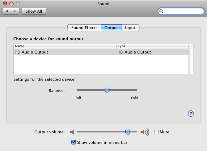

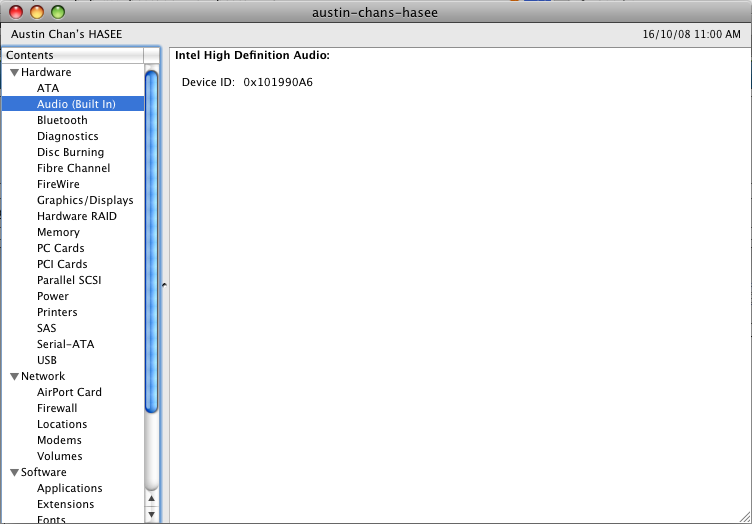

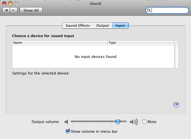

I got a laptop with alc883 ich8 integrated sound card.The only issue I got is the audio line-in jack and only 2-channels from the built-in speaker.
Here you go.It`s the info I can got hope it helps you guys solve the problem.
